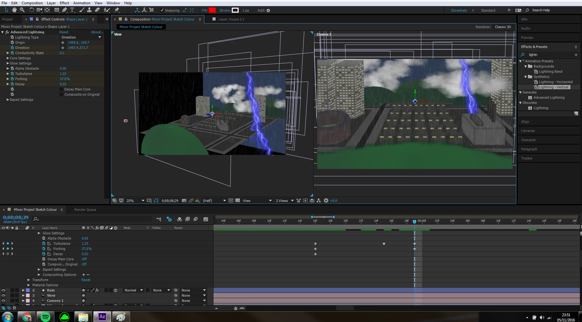

I have only just started using After Effects but I am doing ok I think, I have made numerous images in Photoshop and created a 3D scene out of them in After Effects.
I have begun adding particles such as rain and lightning, and I want to add a spot light to light up the city as the lightning strikes, but when I add a new light layer it does not have any affect on the scene. I have tampered fully with the options but no matter what I do with it it doesn't affect the project at all. I am used to a light turning everything black if the parameters are too narrow, but this is completely new to me and I don't know what's going on. I need this to work for a University deadline coming soon so any help is appreciated.

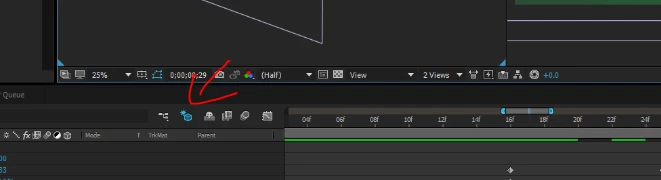

    this is your culprit
    Draft 3D switch disables lights, shadows, and depth-of-field blur for cameras. it's currently active. switch it off.

    Ah! You're my hero, that sorted it.
