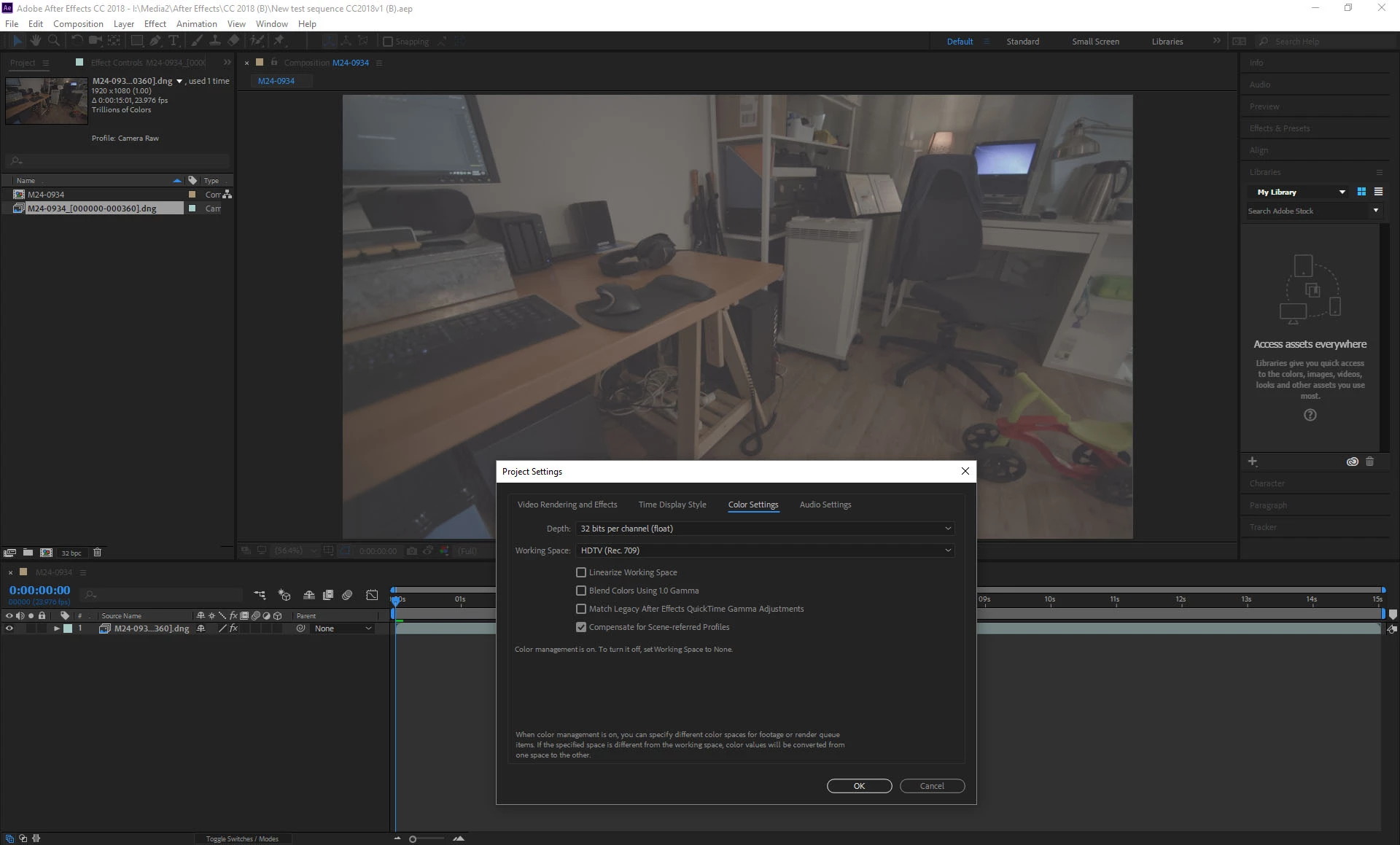

CC applications that can use AE compositions via Dynamic Link (PP, AME, SG) expect a Rec.709 signal. After installing AE CC2018 and converting a current project along with its corresponding PP project, without changing any settings anywhere, Dynamic Link compositions in PP now appear brighter and have less contrast. Exports to Media Encoder have the same shift. To rule out problems with the converted projects, I created new ones for AE and PP, and loaded fresh footage. Same behavior. I uninstalled AE CC2018 without retaining settings, then reinstalled without migrating old settings. Same behavior.
I isolated the behavior to the combination of Dynamic Link and having Color Management on. When color management is off, everything works as usual. When Color Management is on, the shift happens with Dynamic Link, but NOT with exports through the AE Render Queue. Those are fine, too.
For context, I'm generally using Camera Raw through AE to debayer DNG sequences from Magic Lantern raw footage. However, the behavior happens with video footage used in a composition too.
I don't notice color shifts, just an exposure change, so I had a hunch that AE CC2018 is for some reason sending Rec.709 Gamma 2.4 (or thereabout) through Dynamic Link, when PP and AME still expect regular Rec.709 as before. To test, I exported through AE Render Queue set to Rec.709. Exported clip levels were normal. I then imported that clip back into AE with interpretation incorrectly set to Rec.709 Gamma 2.4. The levels in the AE preview are now darker than they should be. Viewed or exported via Dynamic Link, the shift from the wrong interpretation exactly offsets the shift introduced by the link.
I've used this workflow throughout the life of CC2015 and CC2017 with no issues. I did a side-by-side of comparison of the application and project settings between CC2017 and CC2018 looking for discrepancies, and found none. In fact, other than a new font and a few minor text changes in setting explanations, the interfaces are identical.
To summarize, with an example:
Raw footage comes in with embedded profile. (Video taken through the following flow behaves the same.)
Color Management set to HDTV (Rec.709), everything unticked except for "Compensate for Scene-referred Profiles".
A clip exported via AE Render Queue is fine whether Color Management is on or off.
Dynamic Link causes a raised black level.

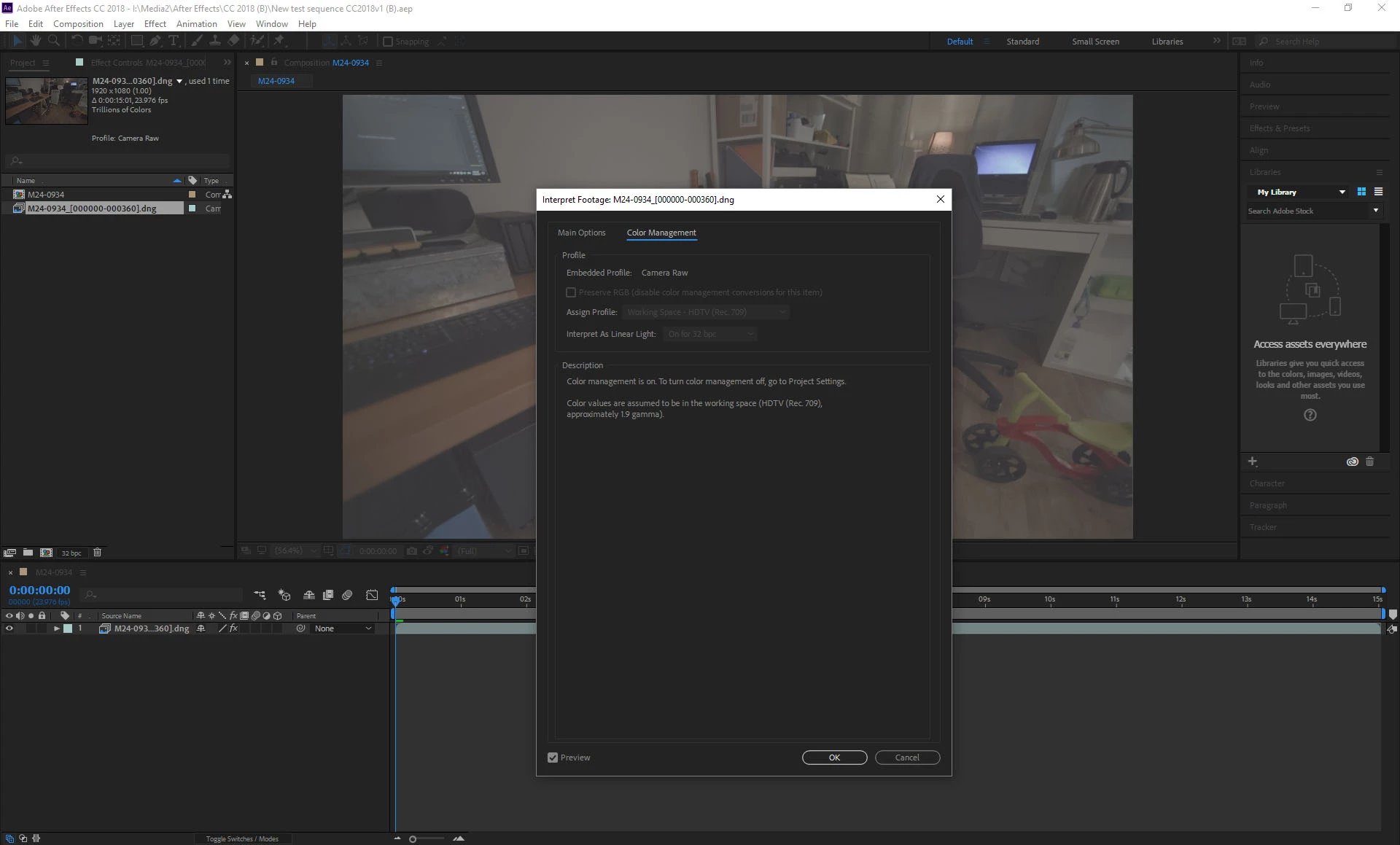

I'd like to share my similar experience with this 709 gamma shift, but not with Dynamic Link. My company uses Avid and our AE projects work in 709 to keep things uniform. As of AE 15.0 (CC 2018) AE interprets regular HDTV Rec. 709 embedded in our Avid exported footage files as HDTV Rec. 709 Gamma 2.4, then converts it to the working space (regular Rec. 709) making the footage darker. The last version of AE to handle it properly is CC 14.2.1.34, which is odd since I would have put money on it being related to the legacy codec apocalypse of 15.1, but 15.0 has the gamma shift issue.
I've provided support with a number of assets to help troubleshoot, including this package of sample footage and screenshots.
At this point, my team is staying on AE 14.2.1.34, but that's not a solution we can live with. Does anyone else have a suggestion or workaround that doesn't involve adding effects or transcoding? We move between Avid and AE frequently and can't afford color shifts.
Here's color bars from Avid > AE 14.2.1.34 working space of HDTV Rec. 709. Profile interpreted properly and not converted.
Here's the same color bar footage from Avid > AE 15.0 working space of HDTV Rec. 709. Profile interpreted as HDTV Rec. 709 Gamma 2.4 and "converted" to HDTV Rec. 709 (which is noted in AE as having approximately 1.9 gamma). Check the bottom right for the most notable difference.
Below is the color management tab for the color bar footage from AE 14.2.1.34. All is working properly - no conversion necessary.
And this is the same tab for the same footage in AE 15.0. Color profile assigned incorrectly, thus shifting gamma.

Generally, once I set a working space, I never touch it again, so it stays in that setting for however many times I open and close a project. Experimenting with toggling that on and off revealed strange but consistent behavior.
(Case 1) Set working space to "None" before saving, so that it is in this state on the next open. On open, levels are correct. Change working space to "HDTV (Rec. 709)", levels shift and are incorrect. Change working space back to "None", levels revert to correct. Change again to "HDTV (Rec. 709)", LEVELS STAY CORRECT. I can continue toggling on and off and the incorrect levels do not reappear. This persists for the duration of the session.
(Case 2) Set working space to "HDTV (Rec. 709)" before saving, so that it is in this state on the next open. On open, levels are incorrect (even if they were correct when the file was previously closed). Change working space to "None", levels shift and are correct. Change working space to "HDTV (Rec. 709)", LEVELS STAY CORRECT. Subsequent behavior is the same as Case 1.
So, it seems that, with each new session, the first time "HDTV (Rec. 709)" is selected as the working space, either through manual selection or opening a file saved in that state, I get the level shift. The act of toggling color management off and back on triggers the correct transform to be used. This sounds crazy, but I can replicate this with 100% success rate.
This means that for the first time, and assuming this quirk continues to work, I can now use the latest version for my work, though clearly this is an unintended behavior and should be fixed.
This workaround only solves the issue of getting correct scopes in AE. Now I can see correct levels on scopes, then output my digital intermediates from AE Render Queue and use them wherever I need. This is good, but limited to this use case.

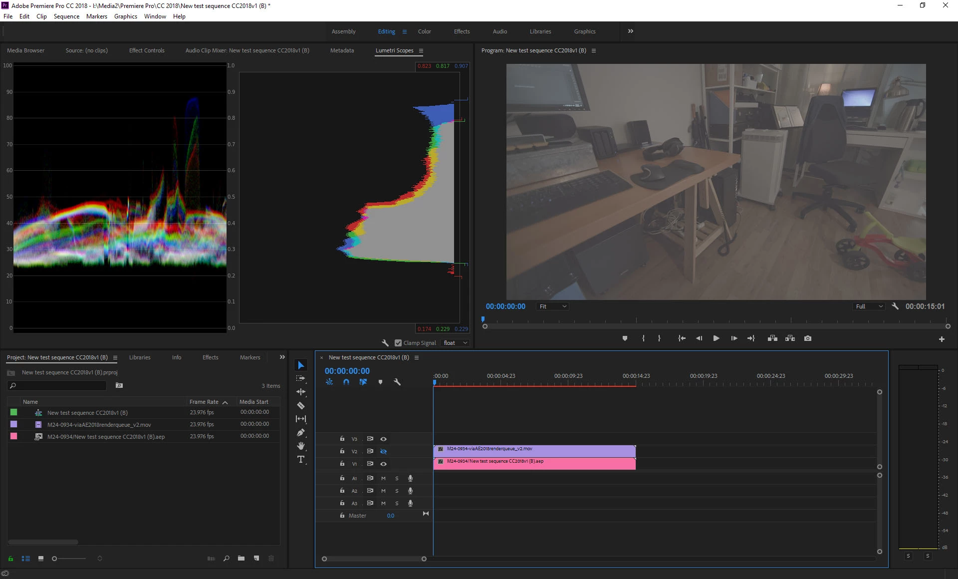

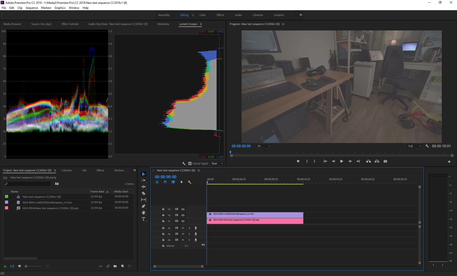

Hi Michael,
Pr now expects Rec. 709 Gamma 2.4 as well, that's why we convert to it when using DL. I tried to reproduce the problem locally with Pr/AE CC2018 and it all looks OK to me. See below.
AE CC 2018:
Pr CC 2018:
Let's talk offline and figure out why you are seeing a difference.

I mentioned this in a private message a while ago, just adding this note here to make this thread a complete record for others to review:
The raised black levels (different for AE scopes and Pr) are also apparent in the screenshots from Vlad in comment 10110936. You can see it in the blue channel on the left side of the waveform, where it's about 36 IRE in AE and 29 IRE in Pr. I think we're looking at AE before it has been "nudged" to make the scopes show correct levels. That relationship of 7 pre-nudge is the same for me, so I'm guessing the true value of that blue trough is about 26 IRE.
