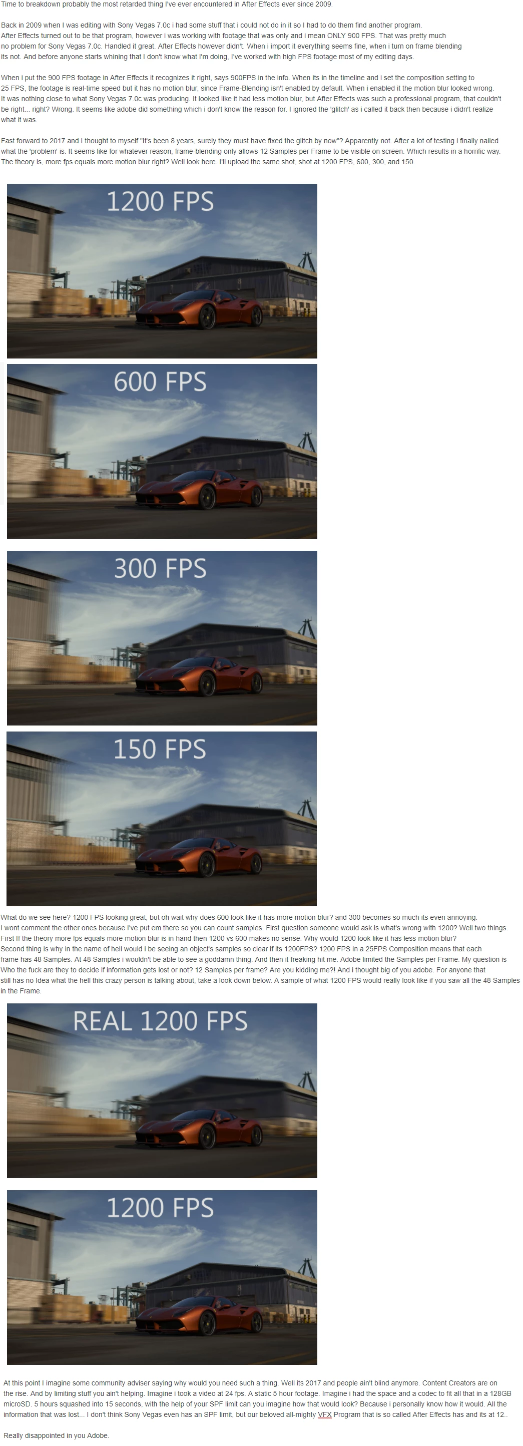

I wrote everything i have to say but i cannot post it for some reason so i just took a pic of everything. Here you go.

Alright I'll try to be pretty plain here. Since it's hard to understand my recording method imagine you have footage that is 1200 FPS.
When you put that footage Into after effects it recognizes it as 1200 fps. When you put it in a composition that is 25 FPS the footage
is real-time. Here is probably where you get lost, imagine you just put the footage in the composition that is 25 fps and when you hit space the movement you see on screen is in real time. Like from point A to point B an object moves the same as it does in real life. But you have no motion blur because the frame blending option is not enabled. When you enable it on the layer that is 1200 FPS after effects shows you 12 samples forward, which creates the illusion that is so called motion blur. But the problem is that 1200 FPS crammed into a 25 FPS composition has more than 12 samples in a frame, it has 48! 1200/25=48 But After Effects has a limitation that only makes us see 12 of those 48 samples, resulting in less motion blur, way less.. As shown in the "REAL" 1200fps. Oh and i achieved the 'real' one by placing the footage in sony vegas and enabling re-sample. Its the same as after effects' Frame blending "frame mix" option.

Guys, the problem is not with me I've done numerous amounts of tests.
Imagine recording a game. The recorder does 60 FPS. You can slowdown the game to 5% speed. When you record 60 FPS at 5% game speed it technically means that when you speed it up to 100% In after effects, that 5% gets sped up by x20. Because 5 fits 20 times in 100. To do the math 60 times 20 equals 1200 FPS. All that put into a composition that is 25 FPS output. If a footage that is 1200 FPS is put into a composition of 25 FPS output what you would see is 48 Samples per frame, or frames per frame, because 48 times 25 equals..? that's right 1200 FPS. But the problem with after effects is that it only allows you to see 12 Samples per frame. Meaning that the higher the FPS of a footage is, the less motion blur it has because taking 12 Samples of objects that are getting closer and closer together means that most of the frames being picked are closer to one another.
This is not me trying to find a solution, there is none. Adobe have to get their stuff together and remove the limit because it pretty much makes shooting at high FPS pointless if all you're doing is shooting at that FPS for the motion blur. We're not talking about slow-motion here. Only what is being generated after the frame blending switch is enabled for the footage. The other frame blending switch is not for motion blur its for slow-motion so don't even suggest that because you obviously have no idea whats going on here.
