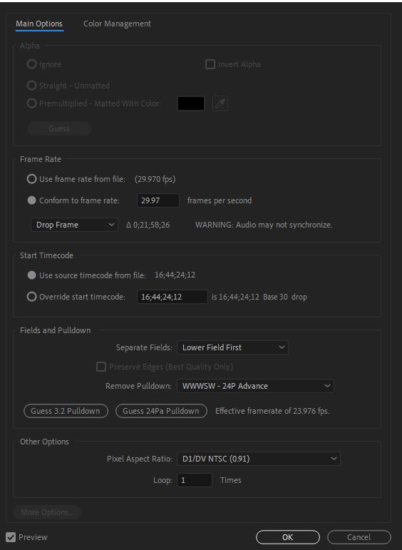

I think understand what you are saying about frame rates.  I've included some screen shots.
The original clips, out of the camera, are 23.976 progressive advanced. In the project panel in PPro, clips read 23.976.
I've always set the PPro Seq Settings at 23.976, here is a screen shot:
When the 23.976 clip is in PPro timeline and I check the properties , I get this:
note:  it reads 29.97 (24p)
Then, when I export that clip from PPro to AE via the 'link'  it turns up in AE and the Frame Rate reads 29.97
IN AE...  my comp settings are 23.976.

Both After Effects (your third screenshot) and Premiere Pro (your second screenshot) are properly interpreting the footage. The original footage was shot at 29.97 fps. That means the playback speed will be accurate. There are no errors here. Unless you want to force your original footage to playback faster or slower than real-time, do not mess with these settings.

The reason the original clips frame rate didn't match the ppro sequence, is....
my ORIGINAL clips all say 29.97  !!!    But they were shot in 24p advanced?????
and the project panel also says 23.976   example:
Why does the project panel show the AVI  as 23.976 ???  When it's really 29.97?  I've been fooled all this time?
I captured all the clips myself, from the camera to the computer and made sure they were captured at 23.976.
Am I totally screwed?
I used media info to confirm the properties of the original  clips.   100's and 100's of clips shot in 23.976 now reading 29.97.

All my clips are reading this....   BUT....   it was shot in 4:3 native.   This reading says 16:9 ??  COULD it be possible my clips are in a container ?  and they have been converted or something?
Jun 03, 2020 Jun 03, 2020
If you shot with an older DVC Pro camera and you set the frame rate to 24P advanced then your footage was shot interlaced with 3:2 Pulldown at 29..97 FPS because that is how we got 24 fps movies transferred to videotape from the very first time film was broadcast on television. Premiere Pro read the framerate and interlacing metadata correctly if your footage looks 4:3 and that is how you shot it.
The "film look" is 99.97% color grading and about .03% frame rate when you are talking about interlaced footage. Your DVC PRO camera didn't shoot at 1/48 second exposure time, it shot at about 1/60. How do I know for sure and how do I believe that frame rate has so little to do with the film look? Because I owned a 35MM Arri BL for years, and I shot commercials for some of the biggest advertising agencies in the country for years, and they spent the extra money to shoot on 35mm film because they loved the look that they got from color negative film stock, and my film looked better than a lot of my competitors because I guy named Clive Tobin build an adaptor for the motor on my camera so that it would run at 29.97 fps so I did not have to do 3:2 pulldown when transferring my film to tape and it looked better.
It looks to me like everything is correctly interpreted. Your original 24P advanced footage was interlaced, lower field first, wwwpw at 29.97 fps so that the frame rate would look as close as possible to the frame rate of film transferred to tape. The progressive output for that kind of project is 23.976 FPS Progressive. That is as close as you can get to having the original interlaced frames turned into progressive frames. The only possible problem you may have is that the footage is supposed to be 4:3 and it has been stretched to 16:9, but you have not mentioned that and the first screenshot you posted shows the PAR as D1/DV NTSC (0.91) which is correct for 4:3 video.

Bottom line, I should treat these clips as  29.97 in regards to in PPro, in AE and burning to a dvd?
Here is the clip interpretation that shows how PPro is reading the clip, which is opposite of the properties in the sequence timeline.(that reads 29.97)

resulting video signals are output or recorded.
When editing images using the conventional
24P [2:3] conversion system, the images of
different frames are expanded for the [BoCe]
[CoDe] [FoGe] [GoHe] frames in the figure,
causing the picture quality to further deteriorate.
Under the 24P advanced conversion system,
images with minimal picture quality deterioration
in the 24P mode can be obtained by weeding
out the [BoCe] [FoGe] frames in the figure.
Furthermore, when an editing system that
supports the advanced conversion system is
used, editing can be performed with minimal
picture quality deterioration compared with the
24P mode.
OWhen an editing system that supports the
advanced conversion system is not going
AND THIS FROM ANOTHER SITE, SAME CAMERA, DVX100A
24p Advanced uses a syncopated 2:3:3:2 pulldown cadence to stuff 24 frames into 60 fields. It's ever so slightly different in its playback; the standard cadence of 2:3:2:3:2:3:2:3... evenly intersperses the "short" and "long" frames, while 2:3:3:2:2:3:3:2... lumps two "short" frames together followed by two "long" frames. The difference is subtle, but can be seen on smooth pans or on regular in-frame motion, like the passage of a train. In my experience so far, about half the people looking at a 24p Advanced clip can see that the motion is a bit different, and half cannot.
But 24p Advanced isn't intended for making the 60i video look like film; it's designed to allow the best possible recovery of the original 24 frames. You'll note that all four original frames can be recovered from self-contained 60i frames; the green frame in 60i now contains the "extra" B and C fields and can be discarded, since all the information for B is contained in the yellow frame, and all the information for C is in the magenta frame.
Extracting a true 24p clip from a 60i recording simply requires copying the raw data for the red, yellow, magenta, and blue frames into a new 24p file, skipping the green frame altogether. No decompression or recompression is required, and all recovered 24p frames retain first-generation quality. No clipping or other loss is incurred; you are still working with all your frames in their first-generation glory in 24p.
Indeed, Cinema Tools goes one step farther: it gives you the choice of either creating a new 24p file, or simply rewriting the Quicktime frame pointers in the original file to skip over the green frames! Rewriting the header is much faster (not that Cinema Tools is slow in writing a new file), but your "new" 24p file is about 25% larger than it needs to be, since it still contains the discarded frames, and you can no longer go back to that file and play it as a 60i file: Cinema Tools has no "undo" for rewriting the frame pointers.
New Here ,
Dec 25, 2022 Dec 25, 2022
After Effects 2023
Edit > Prefrences > Import Show Below Image Change As Per You!
New Here ,
After Effects 2023
