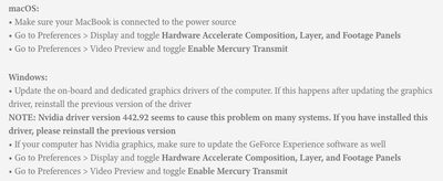

Try this:
Thanks so much for the answer, Byron. That is some great advice. It turned out my GPU was in fact out of memory. My poor little GTX 1080 only had 8GB of VRAM and with all the effects I was using, it needed about 12GB total. Upgrading my GPU with solved the issue and I was finally able to open this project again after 8 months. Using less effects would have also solved the issue. Boa and Layer Sculptor by BAO are both VRAM hogs!

Try this:
Cheers.

Hi Byron, i tried everyting to fix it, but i still get the GPU out of memory-error. I'm working on a MacBook Pro (16", 2019) running on Big Sur, see my specs attached. Comparing to the AE-requirements from Adobe, everything should be fine. What else could be the problem?
Copy link to clipboard
Copied
i guess i fixed it. I just disconnected my 2 external displays. now it seems to work...
