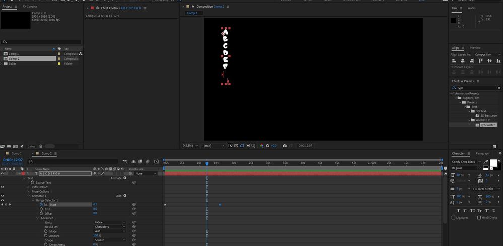

When you say you don't want the Typewriter effect, have you tried the typewriter preset?
In it's default state characters snap on.  In the advanced settings, you can change Units from Percentage to Index, which gives you even more control.
In this hastily set up comp, I have 8 letters in a column, and the start is keyframed from the first letter to the last.  Spread over 16 seconds, each letter appears 2 seconds after the last.
