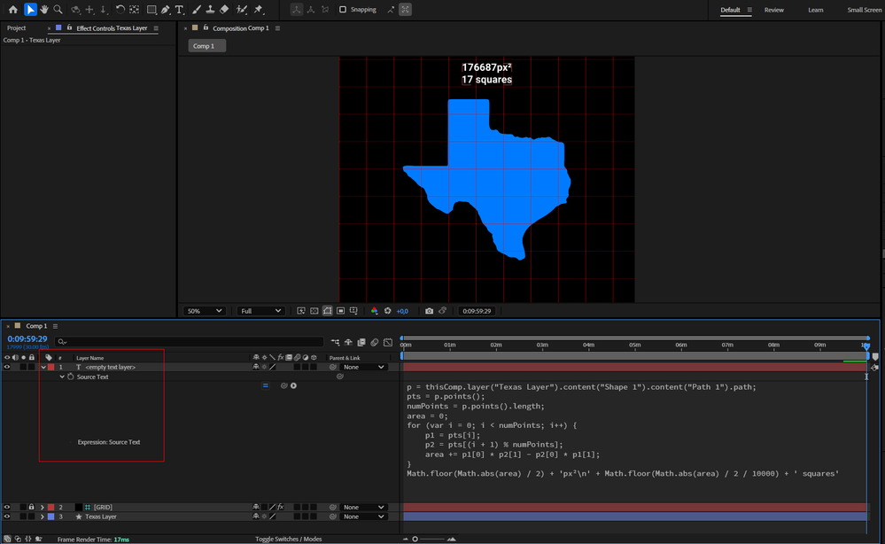

If you don't use too many bezier curves, you can use this expression:
p = thisComp.layer("Shape Layer 1").content("Shape 1").content("Path 1").path;
pts = p.points();
numPoints = p.points().length;
area = 0;
for (var i = 0; i < numPoints; i++) {
p1 = pts[i];
p2 = pts[(i + 1) % numPoints];
area += p1[0] * p2[1] - p2[0] * p1[1];
Math.floor(Math.abs(area) / 2) + 'px²\n' + Math.floor(Math.abs(area) / 2 / 10000) + ' squares'
Copy link to clipboard
Copied

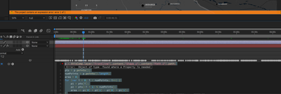

Hi Airweb,
Much appreciate your example. I've tried to test it, but you are dealing with a newbie, so I do believe I am making some newbie mistakes. I can't even get it to work within my project. It gives me the same error that I was getting from bugging the ChatGPT to solve this. So I must be making some blatant newbie mistakes. If you're able to help me further, would appreciate it a lot, if not still thanks a lot for your time!
Copied
In the path property you can only draw a path using createPath()
exemple:
createPath([[-200,200],[200,200],[200,-200],[-200,-200]])
You can use the expression on the Source Text property of a text layer to display the area
