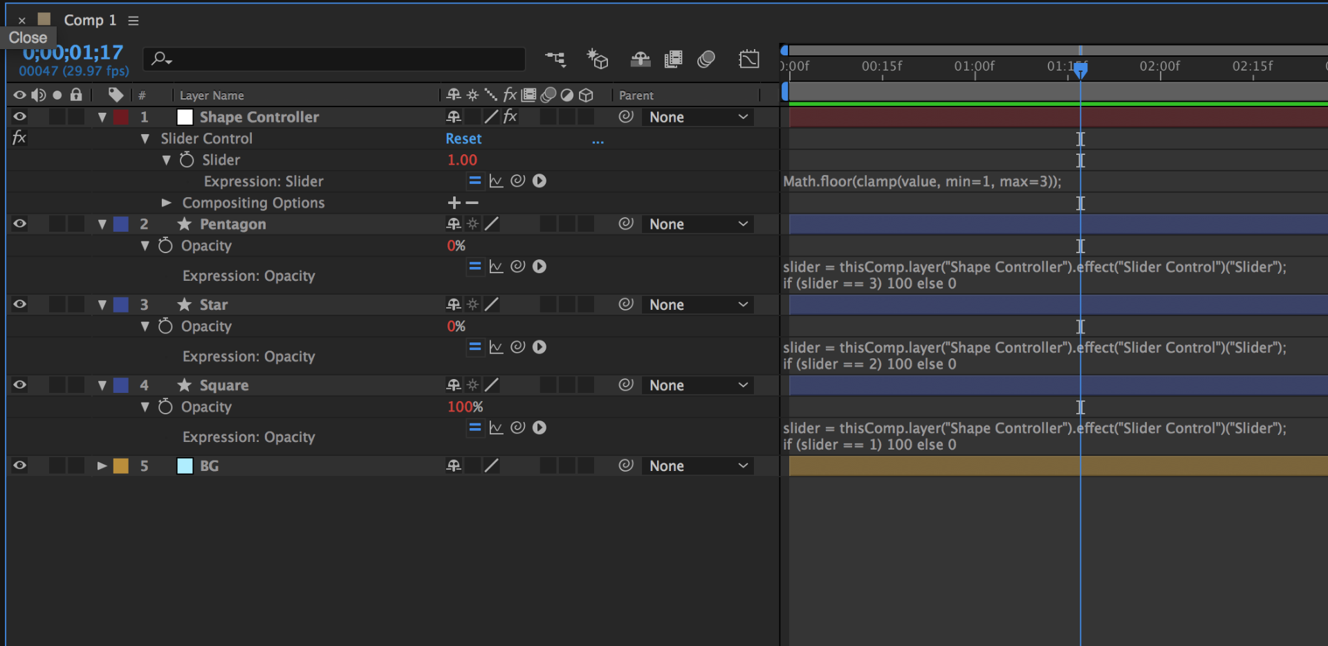

Gotcha. You can do this with some simple expressions and a Slider control. You can also do it with checkboxes, although it's a little clunkier because you would have to turn a checkbox off every time you wanted to turn another layer on. I've done both methods before the EGP was a thing, so it's up to your personal preference.
Attached is a screenshot and a GIF showing how this is done, but here's the simple rundown.
  • Create a null with an Expression Slider effect on it.
    • Limit that Slider's range from 1 to 3 (or however many logos you have)
    • Put an expression on that Slider's actual Slider parameter that clamps the values to only show whole numbers. This is important because while the EGP will show you whole numbers on sliders behind the scenes it's still working in decimals.
      • Math.floor(clamp(value, min=1, max=3));
  • Add this expression to the Opacity of each of your logos
    • slider = thisComp.layer("Shape Controller").effect("Slider Control")("Slider");
    • if (slider == 1) 100 else 0;
      • Swapping the "1" in "(slider == 1)" for the slider number you want the logos associated with.
  • Drag your slider into the EGP and see the fruits of your labor!GIF.gifScreen Shot 2017-04-21 at 11.42.54 PM.png

Worked like a charm. Thank you!
