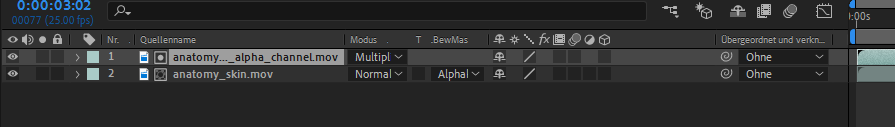

vvvideoAuthor
February 6, 2020
I tried different settings, but I didn`t succeed. Here are my last ones, I hope this is what you meant:

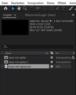

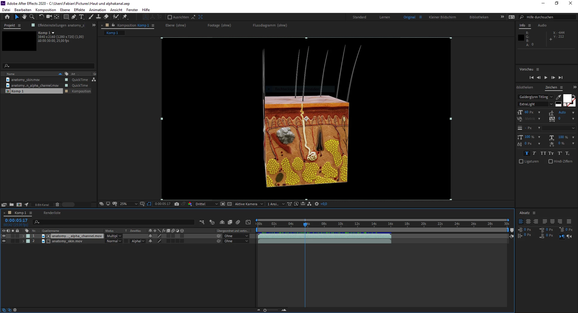

vvvideoAuthor
February 6, 2020
Hallo Mike!
Thank you for your answer! I imported the file back into AE. It lookes like it has no alpha. Here are two screenshots:
