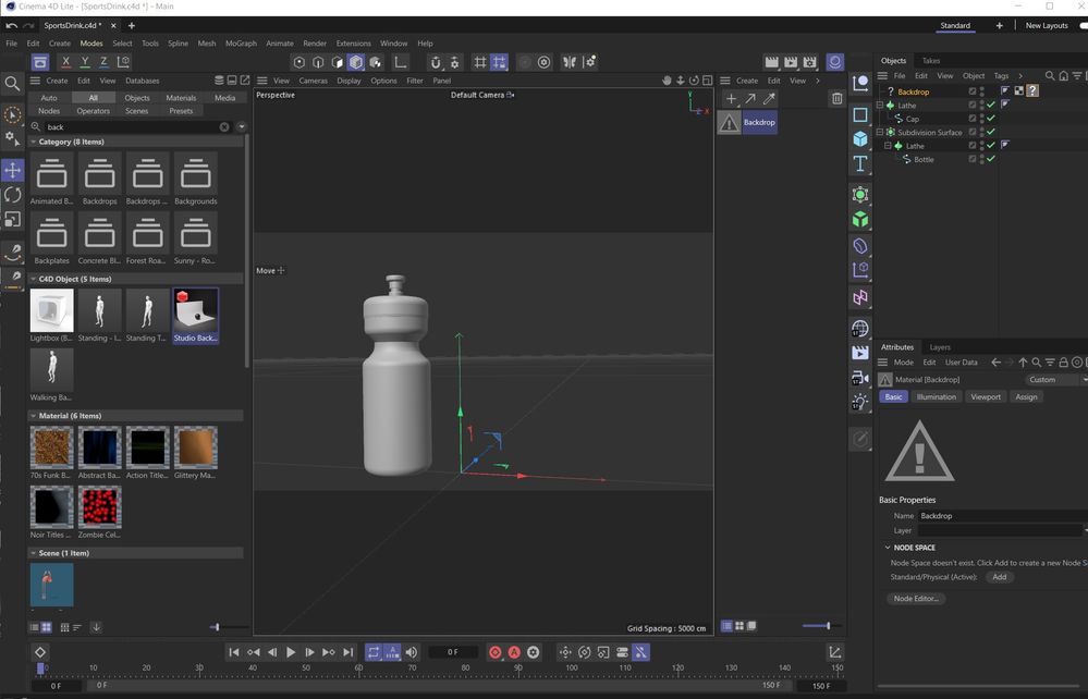

In Cinema 4D lite, I can't get a studio backdrop to be visible.  I double-click it in the presets library but all it get is axes arrows.  The thumbnail for it has a red geometric shape in the presets library and in the object manager there is a question mark.  Seems to be something wrong with the texture.  The texture seems to want a node space.  I tried make a default texture for it, but still not visible.  See attached JPG.  Can anybody help? question mark.jpg

The reason the material is showing up with a question mark is because it's a Redshift material (that's what the Red symbol indicates) and you're scene is using the Standard renderer. I'm not sure if Redshift is available in C4D Lite, although, it might be since Redshift CPU is now included in C4D.
Go to Edit > Edit Render Settings (Ctrl+B) to see what the Renderer is set to at the top-left.
You likely just need to create a new material using the Standard material and drop it on top of the tag with the question mark to replace.
That aside, do you even see the backdrop in your scene? That object also has a question mark and I believe it's because it's a new node-based asset. You might not be able to use that asset in C4D Lite.

Thanks David,
I am following a tutorial book, "After Effects and Cinema 4D Lite" which was published in 2014, so more than a little out of date.  I just did a work-around by downloading a 3D studio backdrop object.  Thanks for your help.
