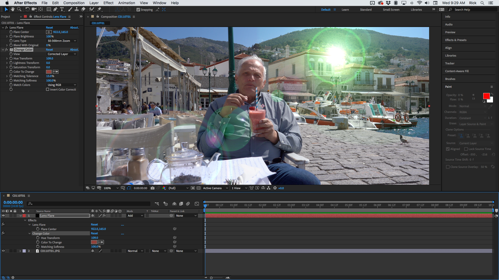

Adjustment layers modify everything below them. Lens Flare applied to a black solid with the Add mode + Change To Color would be the way to go. You would not want to use Curves.
A Black Solid + Lens Flare, moved the flare center. Added Change Color, sampled the most saturated part of the lens flare, changed the Matching Softness to 100% and modified the hue, then set the blend mode to Add. Took about a minute.
Rick GerardCommunity ExpertCorrect answer
October 21, 2020

Well, you designated the layer to be an adjustment layer and within that logic it works as it should. It's the wrong methodology, though. Rather than using an adjustment layer you might simply set your flare layer to a different blending mode like screen or add - as is common practice for this sort of thing.
