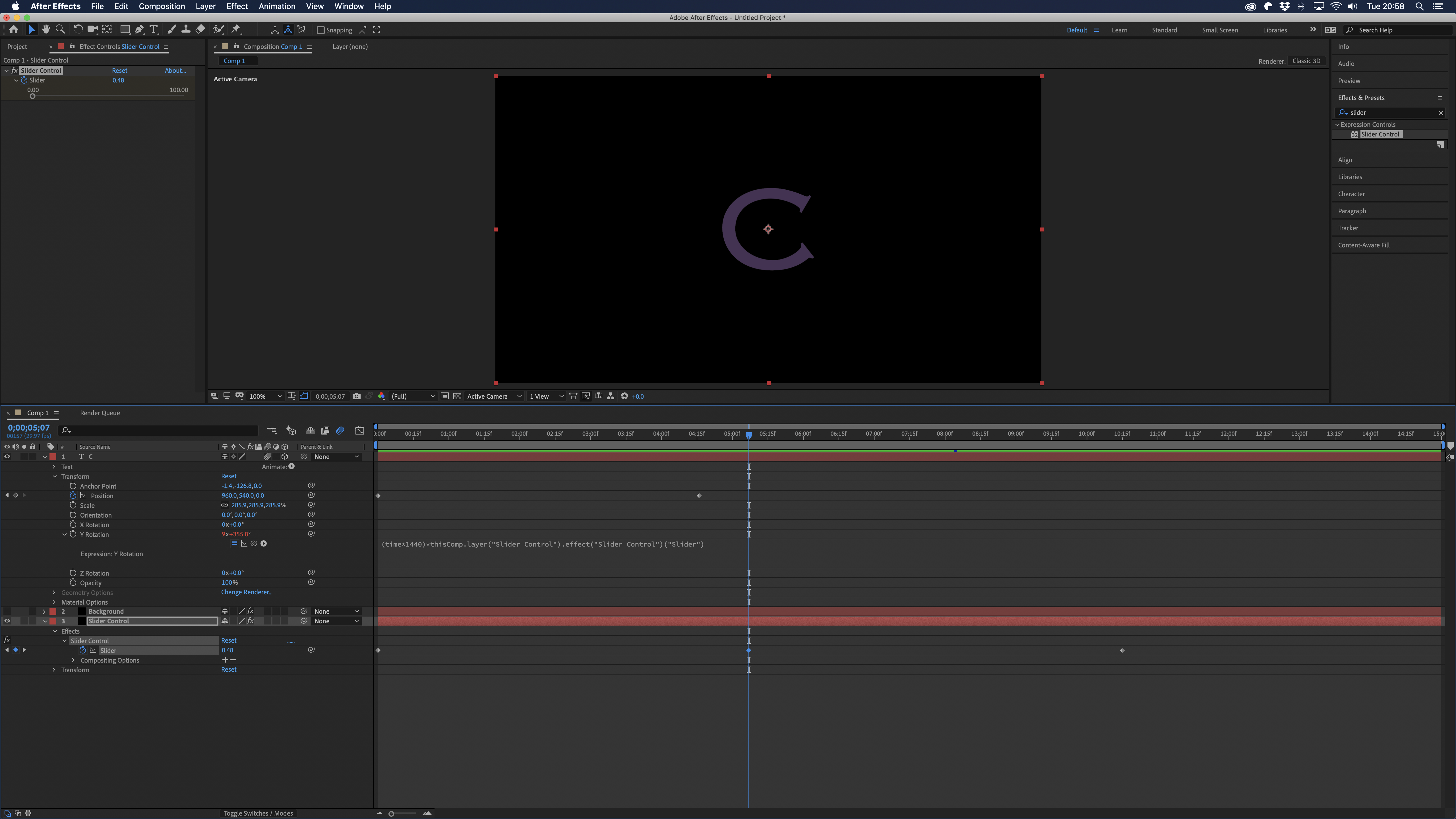

    I know you said that your explanation was in correct but just out of general interest I tried the above using the expression and the slider and it did created the effect I was looking for, well sort of.   I found that once I had set the keyframes and ran the effect it gradually slowed down as planned but it reached what looked like the 0 point halfway through the set duration then it sped back up again, spinning in the other direction.  To freeze the character as in the image below I had to add a key frame just at the right point or otherwise the character would have been facing the other way.
    The formula I used: (time*1440)*thisComp.layer("Slider Control").effect("Slider Control")("Slider").

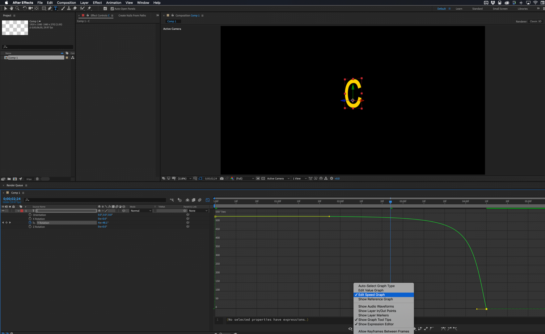

    This is a piece of cake with the speed graph and 2 keyframes. I set the y rotation to 6 in about 4 seconds, opened up the graph editor, selected the pen tool and did a little dragging. Took about 2 minutes:
    When you drag the bezier handle on the right side you have to make adjustments on the left. Once you get the hang of the speed graph, not the value graph, things like this are very easy to do by hand.
    Just multiplying time by the slider won't give you as much control over the curve and could make the rotation reverse. If you want to use expressions to control the speed of anything you should look at Dan Ebbert's Expression Speed and Frequency Control.​ That's the only way to gain complete control over speed and time using an expression. The first two or three paragraphs explain why just multiplying time by a slider will not work very well.
