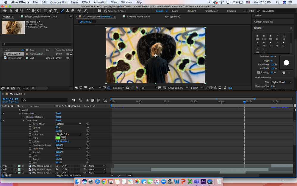

HELLO! I need major help! my glow effect ( after the whole robobrush tool and adding the outer glow into the selected layer ) is not smooth or spreading nicely. I tried to readjust everything under the outerglow effect settings and the glow around my objects are just thick transparent lines. I do not understand. Can someone explain what is wrong?

The main issue is the "Spread" parameter in your Outer Glow.  At 100% you'll just get a hard edged line, as you're seeing.  Set Spread to 0, then increase the Size parameter to expand the size of the glow.  You'll see a much smoother soft edged glow as a result.  You might also consider reducing Noise and Jitter, unless you particularly want a speckly looking glow.
You might also want to try the Effects/Stylize/Glow effect, rather than a Layer Style, which looks a bit more organic and can have Motion Blur without precomposing, which Layer Styles can't do.

It's very hard to assess your issue from your description.  Can you post a screenshot of the problem comp, with all the glow parameters visible?
