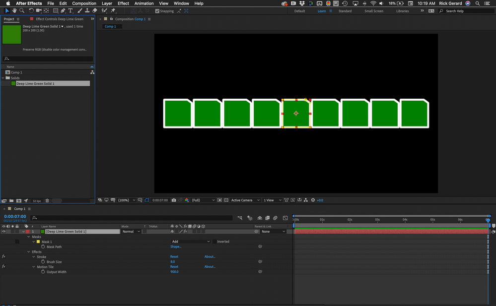

I am not sure how you are using Offset in Photoshop. By default offset just moves a layer around. If there is transparency then you get holes in the image because offset, by default, moves the whole layer around.
Motion Tile repeats the layer and it is based entirely on layer size. If you add a solid that is smaller than the comp, create a mask around the outside edge, then add motion tile you get a bunch of copies of the layer without overlap.
It would really help to see your timeline and have a better explanation of what you are trying to do.
