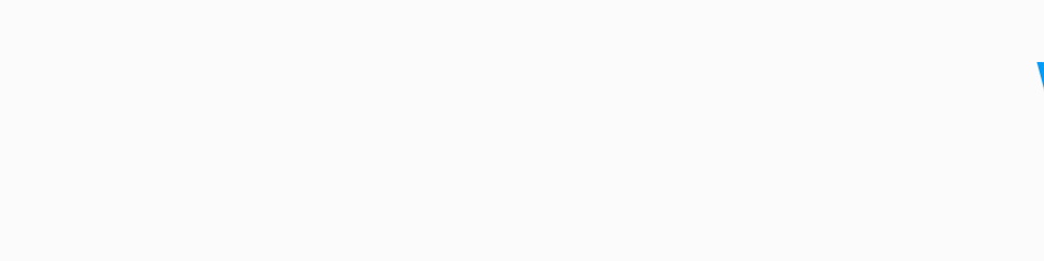

I have this GIF animation for my job that I created in After Effects and sent to Media Encoder I set it to Animated GIF and matched the settings. When i play it in my web browsers they all do the same thing. The text is repeating as it slides, can someone please explain what is causing this.
