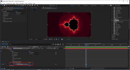

For me, the easiest way is to change the Effect Opacity property on the Timeline panel.
You can stop it abruptly or create a smooth fading. Later you can learn how to animate it with expressions and a great new experience 🙂
Here the effect is stopped quickly using the Opacity changing from 100 to 0 in the adjacent frames.
