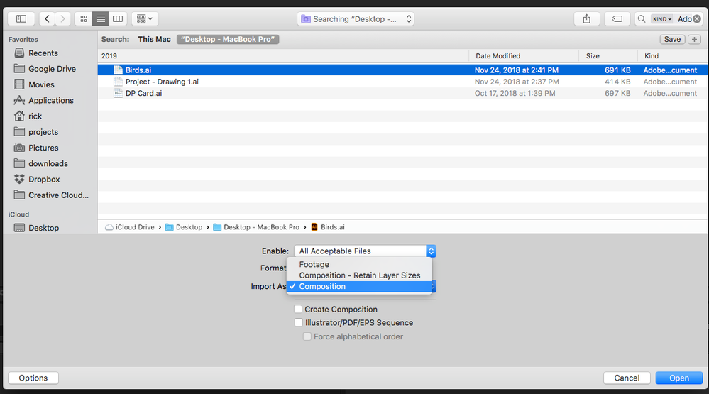

By far the easiest way to do this would be to prepare your AI file with each path you want to use on a separate layer in the proper position, import it as a Composition, then select the AI layer you want to use as a mask in the timeline, select Layer/AutoTrace from the menu, adjust the settings while previewing the output, then using those masks as needed.
Most of the time I import AI files as a Composition/Retain Layer Size, but this would give you a solid just the size of the layer and you probably don't want that. If you are using effects like Saber or UltraZap you'll want some room around the masks. Importing as a Composition makes every layer the size of the composition frame and that's what you want for this kind of work.
