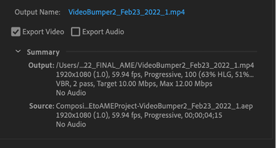

The setting are listed above, but here's a couple screenshots...
Comp settings:
Export settings (in AME):

My first comment would be your bitrate seems low for me for a 'master' quality for the other user to place in their sequence, then re-export. I would think that something over 25 would be better for a 1080 export.
I would also not include the gamma compensation LUT at this point. Just letting the end user decide what they need.

I wondered if the Bitrate was set too low, didn't know if I needed to keep the file size down. I'd much rather sacrific size than quality.
I've been using the LUT because my colors were coming out lighter, washed out when I exported, but the gamma compensation LUT fixed that.
I'll trying buming up the bitrate first as see how that does.
This is probably impossible to answer without knowing the details, but are there settings I should suggest to the videographer to help improve the quality when he exports from Premiere Pro (which I know nearly nothing about). Again, these mostly are for YouTube uploads.

For producing that media for use in another project in Premiere, definitely keep the quality up. Don't worry so much about file size ... get that bitrate up. Probably the one best thing you can do to help with the quality of their YouTube uploads.
As to the gamma comp LUT ... that's a different question. Because what that does may "fix" it so it's not too bright on your machine outside of Premiere ... but it bakes into the file a darker, more saturated image than the actual Rec.709 image should be. So when viewed on a non-Mac screen, it will likely be too dark. May easily have crushed blacks ... and there's no recovery possible, the data's not there.

I tried what you suggested, bumped up the bitrate and left out the LUT, and that made the difference. The image quality is much improved.
