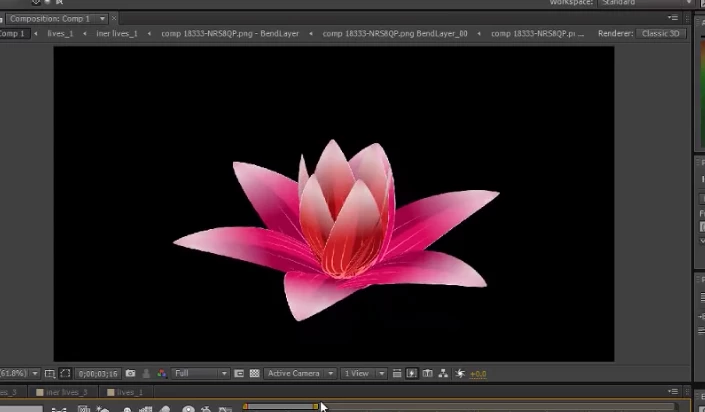

How was this done? Flower petals opening

Does anyone know how this was done in After Effects? These flower petals seem to "curl" outwards. Is that possible without special plug ins?

    Correct answer P.M.B
    CC Bend it or CC Cylinder or one from that group.  A single png of a petal with a pivot at the bottom rotating out and the CC Bend It key framed from slightly curled in to curled out.  Parent it to a null so you can move & scale it without worries.  Duplicate for each petal.  Arrange them all in 3D space using the nulls.  Add a camera so you can rotate around and find a nice viewing angle.
    That's one method that might work.

    Another fantastic way to do this would be using FreeForm Pro for AE.  It is made by Mettle and it is a purchase item but it is very powerful and would do great for this.

    I asked the creator, a nice guy in India. He said he'd show me, but I haven't heard back from him.
    I was hoping for a simple solution. All I need is some tiny 3-D flowers blooming on different locations on a  map.  So they'll be quite small.

    Hmm... CC Bend it doesn't seem to really curve in 3D. it seems to bend over to the side, but it's not really curling over on itself.
    You could ask the creator how he did it.
    It very well could be actual path animation as well - essentially hand-animating the petals.
