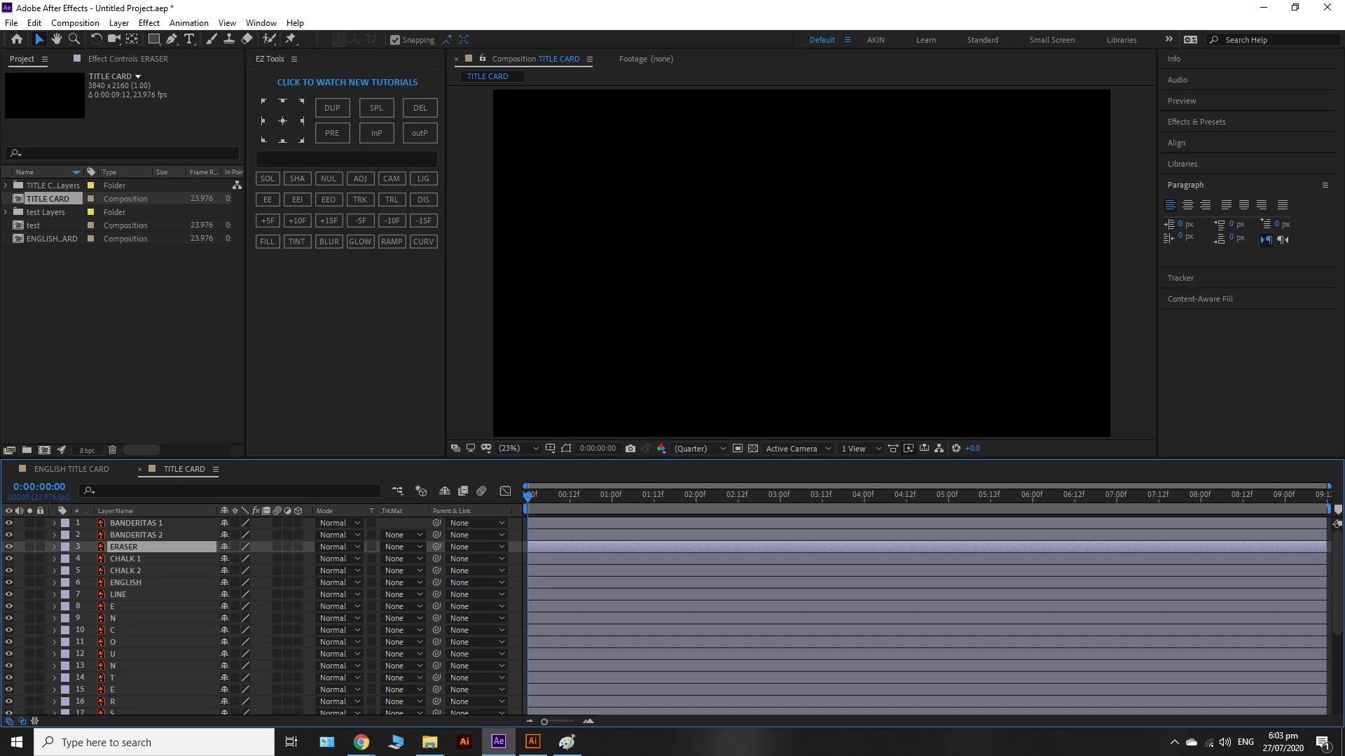

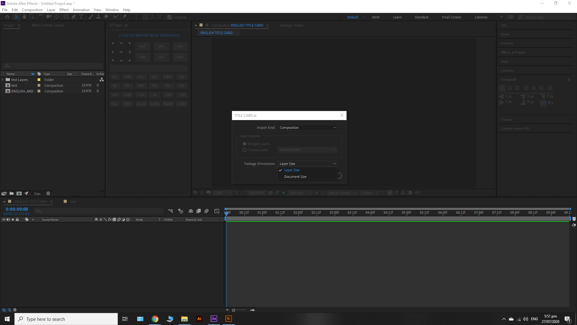

Another issue is what it says in the subject. Now that I've downloaded the cloud, whenever I create graphic designs in Illustrator and import it in After Effects, the file is invisible and appears black. I've tried re-saving it and making sure the compatible with PDF is ticked when I save it in Illustrator. and when I import it in After effects I make sure these are my settings in importing
I also double checked if I have the Caps Lock on and it is NOT turned on. I even redid my design in illustrator and made sure I only have one artboard. Still it appear as this:
