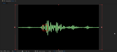

Is there a way to center the audiowave spectrum?
  • October 10, 2022
  • 1617 views
Hello there, I'm not sure if this is possible but I'm trying to see if I can make the audio spectrum "start" in the center of the wave? In the image below you'll see the audio "starts" or is most sginificant on the left. Is there a way to make it so that is actually the center of the wave?
Thank you in advance!

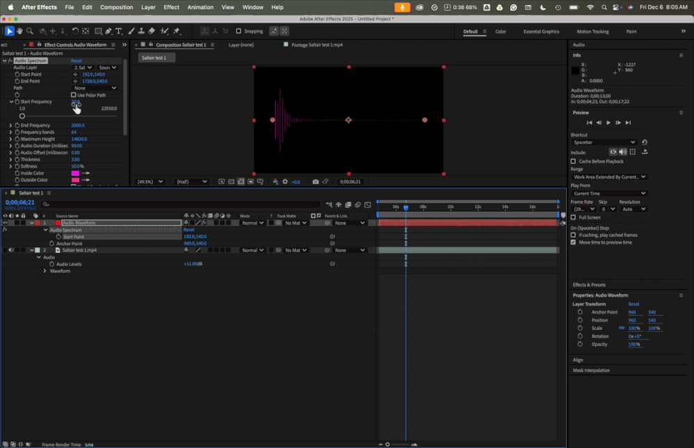

Jose Panadero
October 10, 2022
There are a couple of ways to do it. The first one is to use the Start Point parameter to set the new start location. The second way is to add a custom mask where you want the audio spectrum to be placed and then use the Path parameter to set the position of your audio spectrum over the mask path.
Robot Bubble
October 10, 2022
Where do I find the Start Point Parameter settings?
All I can find for the Audio Spectrum is the Start Frequency.
Jose Panadero
October 10, 2022
Check the attached image.
