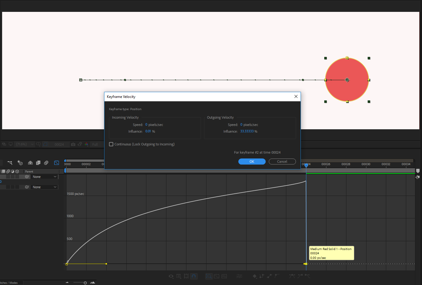

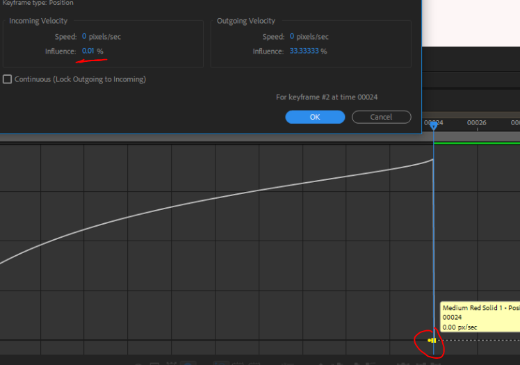

I see the neighboring keyframe doesn't affect his influence  ?
do you mean speed? influence cannot be affected by changing the relation of the keyframes. speed can. it is now not affected by changing the relation of keyframes because the handle is at the minimum influence.
if you give it more influence you will see the speed changes as you place it up or down left or right.
changing the relation with keyframes affects the speed, not the influence. the influence stays the same and is not affected by changing the relation of keyframes.

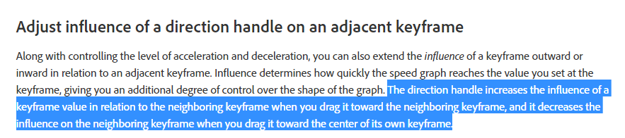

Thank you. I mean the influence .. as adobe help says on the  After Effects User Guide :
The direction handle increases the influence of a keyframe value in relation to the neighboring keyframe when you drag it toward the neighboring keyframe, and it decreases the influence on the neighboring keyframe when you drag it toward the center of its own keyframe.
So the handels affects the influence for the nighboring keframes ? But I see it's affect the shape of the curve .?

I just want to know What does the author mean, by increases the influence of the previous keyframe’s value. ?
My English doesn't help me much , I still confused when i come to read this line .
see the whole page here :Adjusting Temporal Interpolation Manually
LEGEND ,
Jan 10, 2018 Jan 10, 2018
I get the confusion. when you drag the influence it only affects the current keyframe, not the previous. you can only affect the influence of the incoming or outgoing velocity of a keyframe and dragging each handle won't affect the influence of other keyframe. I guess it's written in an inaccurate way.
