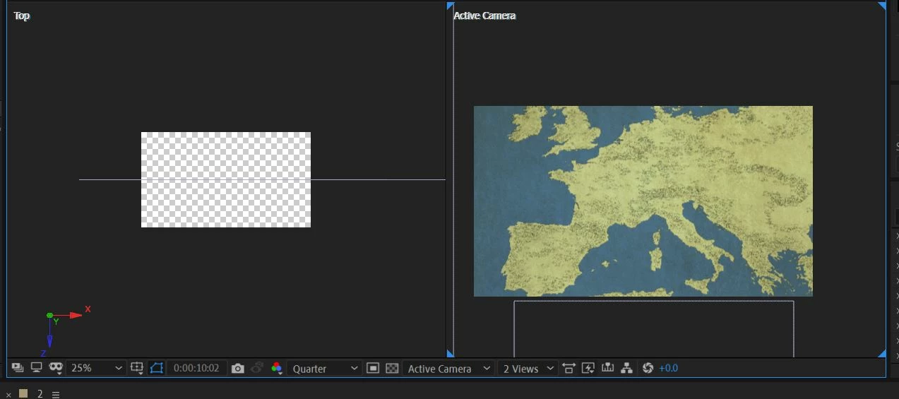

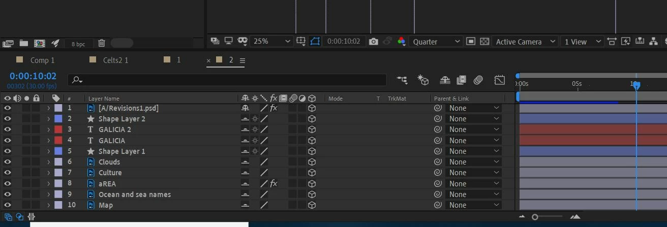

When I do the same to my map and make all layers 3D, all the layers above the map PSD disappear:
Now I understand about 3D space, and they may be on the same Z axis so do not appear as a result. But I am curious, why would I have to manually adjust every layer yet the person making that tutorial didn't, as his layers didn't disappear when made 3D? What gives?
Surely I do not have to adjust each layer on the Z axis after making my map layers 3D?
Any insight would be helpful as I have to make a tonne of these maps.

You should be using the Classic 3D rendering option for your comp. Your screenshots are cropped so I can't see what the comp is set to use and I can't see the position of any of the layers or the camera because you did not reveal the modified properties of any of the layers.
Your GPU may be causing problems. You can test this by creating three layers using different colored solids or different shape layers. If you make the layers 3D and some of them get hidden try changing the GPU settings in the Project Settings.

One of your suggestions seems to have done the trick; switching 3D renderer from 4D to Classic 3D and the problem is gone. Who knows why? I will also save and use your expression in future, as I am sure I will need that at some point.
May 8, 2021
The C4D Rendering engine works that way because all the layers have depth, even if it is only one pixel.
If you start rotating those layers, even when they are parented, you can get all kinds of artifacts if they are not offset by one pixel. If my 3-D layers are going to share the same basic Z space on the stage, I always use that expression on the Anchor  Point.
