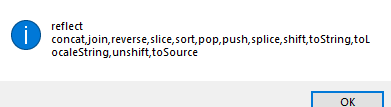

I have a strange case where several extendscript methods are missing on my main computer, where they are present in my beta installation, or on fresh installations on other computers. I can't explain the difference in possibilities. Any help is much appreciated.
What i've tried so far:
Uninstall / reinstall every adobe app
Uninstall / reinstall every adobe app with the adobe cleaner tool.
The difference can be seen when alerting a reflect of an array:
var myArr = [];
alert("reflect\r"+myArr.reflect.methods.join(","));
This results in the following alert in my main pc:
But this one on all other pcs/installations i've tried so far, including beta on my own main pc:
Notice the methods at the end:
indexof, filter and map.
Any explanation would be most welcome.
A potential fix would be perfect!
Thanks guys!

We received the following info:
Launching 'Learning' adds in Array. indexOf, which other jsx scripts can see and access.
Launching 'Libraries' panel adds Array.indexOf, Array. filter, and Array .map (which again is accessible from your own scripts).
All of them will also add JSON.
So, depending on which panels you load in at start, or later, as soon as one of these are loaded you are adding functionality untill you close AE again. So, while it is true in my case that the extra methods were added by "external code", it was in fact "external code" from Adobe themselves, it appears.
Very interesting and explains a lot!
