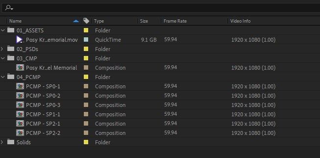

It looks like an incorrect interpretation of the clip's timebase. What is the original frame rate of your clip? What is the timebase of your composition?.
MNowicki
MNowickiAuthor
October 3, 2022
I don't believe it's the frame rate issue. Everything including the comp are 59.94. See screencap below.
