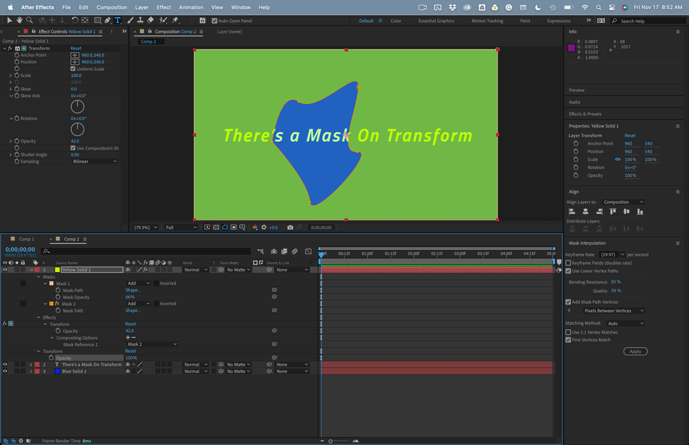

Here's the hierarchy for opacity. Every control you add below the first one adds to the value of the previous control. Opacity is subtractive, so if you set opacity to 70% with the first control on the list, you can't increase it by adding value with the next one down the list.
  1. Double-click the Rectangle tool to create a layer-size mask, press 'mm' to reveal the Mask Opacity - set some keyframes or use an expression to an additional additive opacity control
  2. Add the Transform Effect to the layer and adjust the opacity
  3. Add an additional smaller mask to the layer and assign Mask 2 to the Transform properties to fine-tune the opacity
  4. Set keyframes or use expressions to control the layer's Transform/Opacity value.
If you want to just flicker the opacity using an expression, then you want to keyframe the opacity to fade out the entire layer try using an expression that adds the flickering expression to the value of the mask.
Something like this would work:
value + effect("Opacity")("Slider");

November 17, 2023
Have you tried the Transform effect?  That has all the layer property controls, including opacity.
November 17, 2023
Thank you. Tranform it does work as a double transparency.
