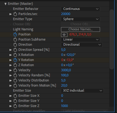

    Oh yes I forgot to mention!
    I use After Effect CC 2018, and the plug in Trapcode Particular 3. For the setting of the particules there is 3 screenshot.
    For the Physic I change to Bounce and add much more gravity to it, I add the layer floor for the particles bounce on the floor, which they did but they don't bounce off screen just like you can saw on the very first screen. For the left side it's pretty much the same except for the physic I set it to 500, and the Size over life is a M shape.
    The top and left side are exactly the same, but they go off screen just like I want, but not the one on the bottom and on the right side why is that?
