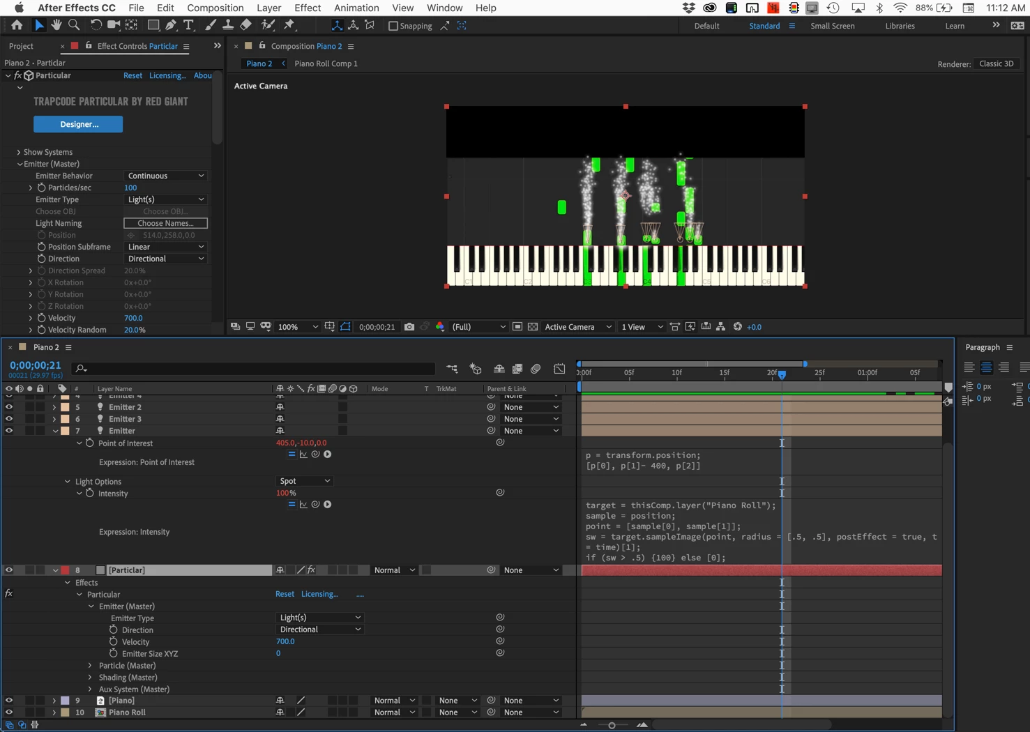

I've been trying to follow your tutorial, but I seem to be missing something.. Now the particles aren't showing at all. Here's a screenshot of it.
When you send a screenshot it is important to reveal the layers that are giving you problems. If we can not see what you have done to the layers giving you problems a screenshot is almost completely useless. Press the U key twice and post another screenshot.

There you go. There's not much to making Particular start and stop a particle stream based on the color values of a sample layer. Here's a screenshot with most of the modified properties of the layers revealed. I just used a bit of your screenshot for the footage and got the piano roll to move by masking, animating position, and pre-composing.
