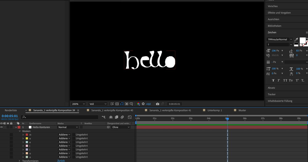

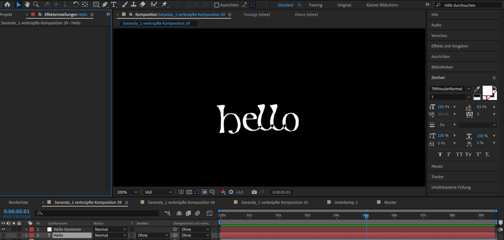

I have a problem with "Create Mask from Text", as can be seen in the first picture, the text is not completely filled out. As can be seen in the second picture, this is what it looks like when I enter the text normally. I need the mask from the text to be able to apply a pattern/texture from Photoshop to an animated text.
The mode in the mask for each letter is set to "Difference" by default, so it doesn't always work that the letters are displayed correctly when the mode is changed. But either way, that wouldn't be the solution, because I don't want to change each letter individually in a long text.
Does anyone know any helpful advice to make the mask look like the second picture?

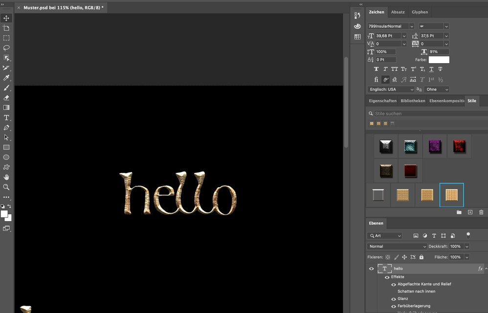

Yes, I'll explain, so I created a "style" in Photoshop, a "medieval" text. (see screenshot) So that I don't have to save each text I need as an image in Photoshop (and I also need text animation), I have to move the whole thing to After Effects. Then I came across the already mentioned video, which I already linked, which helped me on how to import and use this created "style" on a text in After Effects as well. The layer style is imported, but not the pattern overlay. So, as he says in the video, I need to create a shape layer in Photoshop first, with the "style" on it. Then save it, import it into After Effects, then I create a text. He does “Create Mask from Text”, in my case I have to do “Create Shapes from text”, otherwise there will be overlaps in the words again. Then this mask of the text is copied onto the Shape Layer Photoshop file. That's why I need the mask after I've converted the text to "Create Shapes from Text". So that the pattern overlay is also on the text.

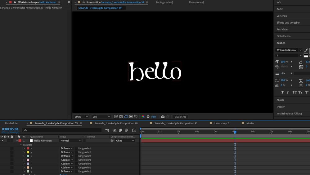

Got the solution, after applying "Convert Shapes from Text" then to "Auto-Trace", then a mask is also created and there are no overlaps in the text, thanks for the help here! 🙂

For example, if I change the mode of the letter "l" to "add", then it works, then it is filled out normally. So when selecting a letter individually, it usually works (see image 1), but if I want the workflow to be faster, with a long text for example, and select "Add" for all letters, then it looks like the second image ... unfortunately I don't know how to simplify this...

You can try to use the "Convert shapes from text" command. This way, you will get a similar result. Then add a Merge Paths operator to the shape layer and change the mode to Exclude Intersection. See attached image
