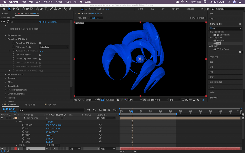

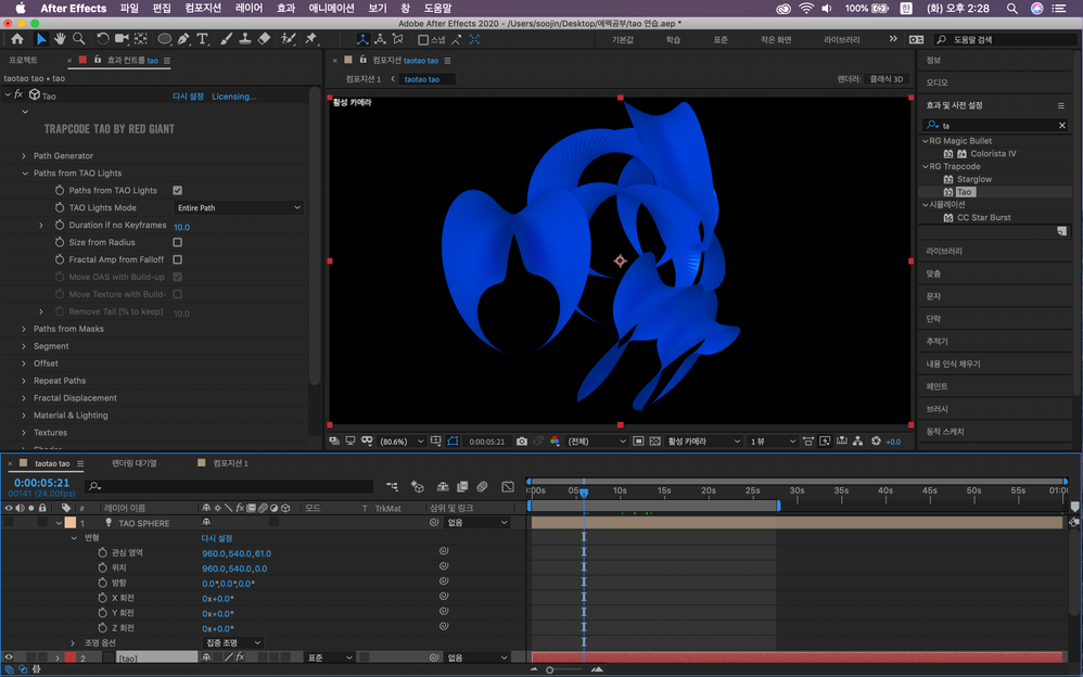

I wanted to add a core or a sphere to my original Tao object, but when I add this "TAO SPHERE", the original shape changes. I setted the "segment-sizeX" to be '1' but when I add this light layer, it suddenly have more SizeX value. I can't increase of decrease it. It just happens to have increased SizeX. what is happening?
or I can make a 2D with cc sphere, I've seen someone's question which had been already answered, in the support coummunity, but i don't know how to do it. please help. thanks in advance.
Im not originally English user so please give a easy description. or maybe some images.when added TAO SPHERE light layerwhen added TAO SPHERE light layerno light layer.no light layer.

It looks like you need to study up on TAO. I'm not sure because I can't see the modified properties of the TAO layer (press uu and post another screenshot), but I think you are using more than one path generator. Turn on a light and TAO creates a path from a light path. When you turn off the light and the path disappears. If you have a fractal applied it will apply to all paths that are on so it makes sense that the fractal will be different because the paths are different.
