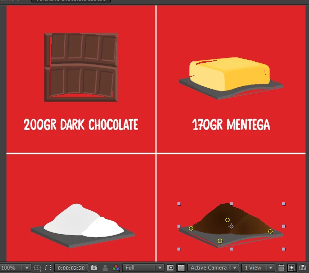

hello, i want to ask
when i using pin tool, and i scale the image, the pin tool make it broken
like this one, i using pin tool, make the image make squishy movement
but when i scale it (i make the image come out like.. hmm i not sure waht its called, maybe popout?)
the scale was : enter > 0 >100%
then out > 100>125>0%
as you look on the image i post, pin tool make the asset damaged
is there any method to fix it?
thank you!
edit : and yeah forgot to ask, why some image have smaller area than it should when i using pint tool to them, like this one
(the area size only inside the yellow line)
make it perforated when i try to make it squishy

Have you tried increasing the Mesh "Expansion" value?  If edges of your source footage tear, increasing this value usually resolves the issue.

setting more expansion is definitely worth pointing out and can work to some degree, but as soon as your transform properties reach the mesh's boundaries, puppet will break again so take that into consideration. setting more expansion can also have an effect on the desired result and even more so if you are animating transform properties. essentially you are moving a layer inside a closed mesh (that is usually animated too). since the layer is collapsed, the mesh does not obey the layer's transform properties i.e the mesh does not adjust itself and grow, rotate, move with the layer - the mesh and the layer are kind of disconnected so this can result in all sorts of oddities.
that's the reverse render order which is introduced when using collapse/continuously rasterize switch: instead of effects and then transform, it's transform and then effects.

All distortion effects are sensitive to transform operations and the puppet mesh in particular. It always has to encompass the whole shape. Pre-compose and apply the Puppet stuff after you have scaled inside the pre-comps.

Puppet pin only works on a layer that has no transformation or distortion effects applied. Puppet pin works on the information in the first frame so if that  changes over time then the effects breaks. It's always been that way and it's that way with several other distortion effects. When in doubt or when facing problems you can't seem to solve, pre-compose.
