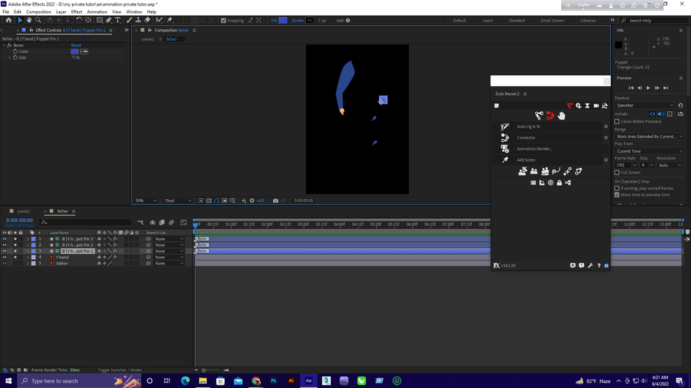

Jun 03, 2022 Jun 03, 2022
New Here ,
when add bones didn't add on specific object in after effects.how can i fix it?
