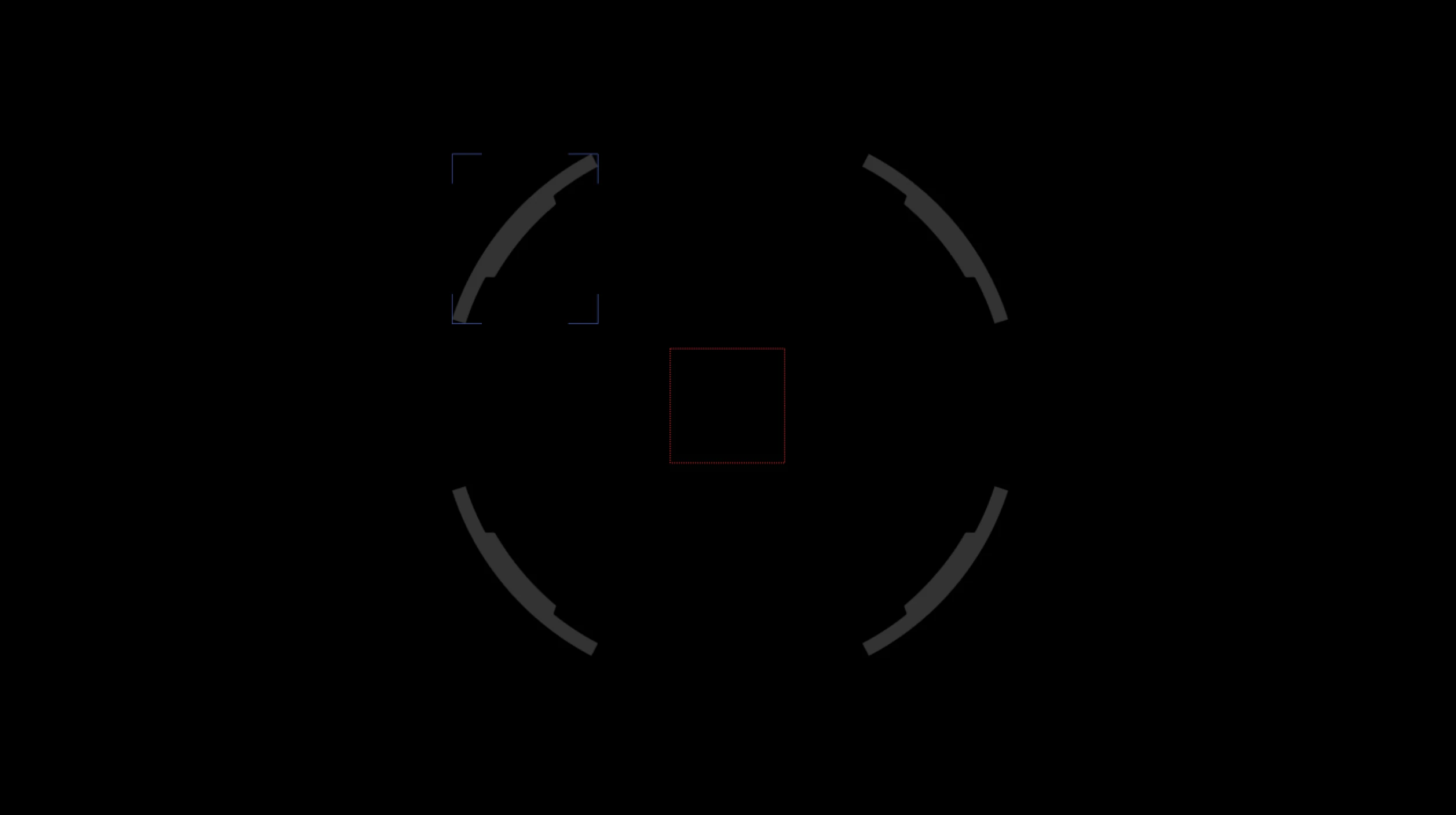

Hello all,
I'm trying to create a target reticule effect where four separate objects converge on a central point. To do this, I've parented them to a null object and set up a script to work off the null's scale property.
The script I use is:
pSc = parent.scale;
x = value[1]*100/pSc[1];
y = value[0]*100/pSc[0];
[x,y];
I also use a separate script to maintain the child layers' scale, but that doesn't seem relevant to my struggle.
The problem occures when I change the parent scale and the entire array moves in a uniform direction. Instead of converging on the center, I wind up displacing the array.
As far as I can tell, the object in the upper left is moving as I wish. It's the other three that need some kind of inversion, but I'm not sure how to modify the script to accomplish this.
Any suggestions?

Here is a screenshot of my expressions and the layout of one object.

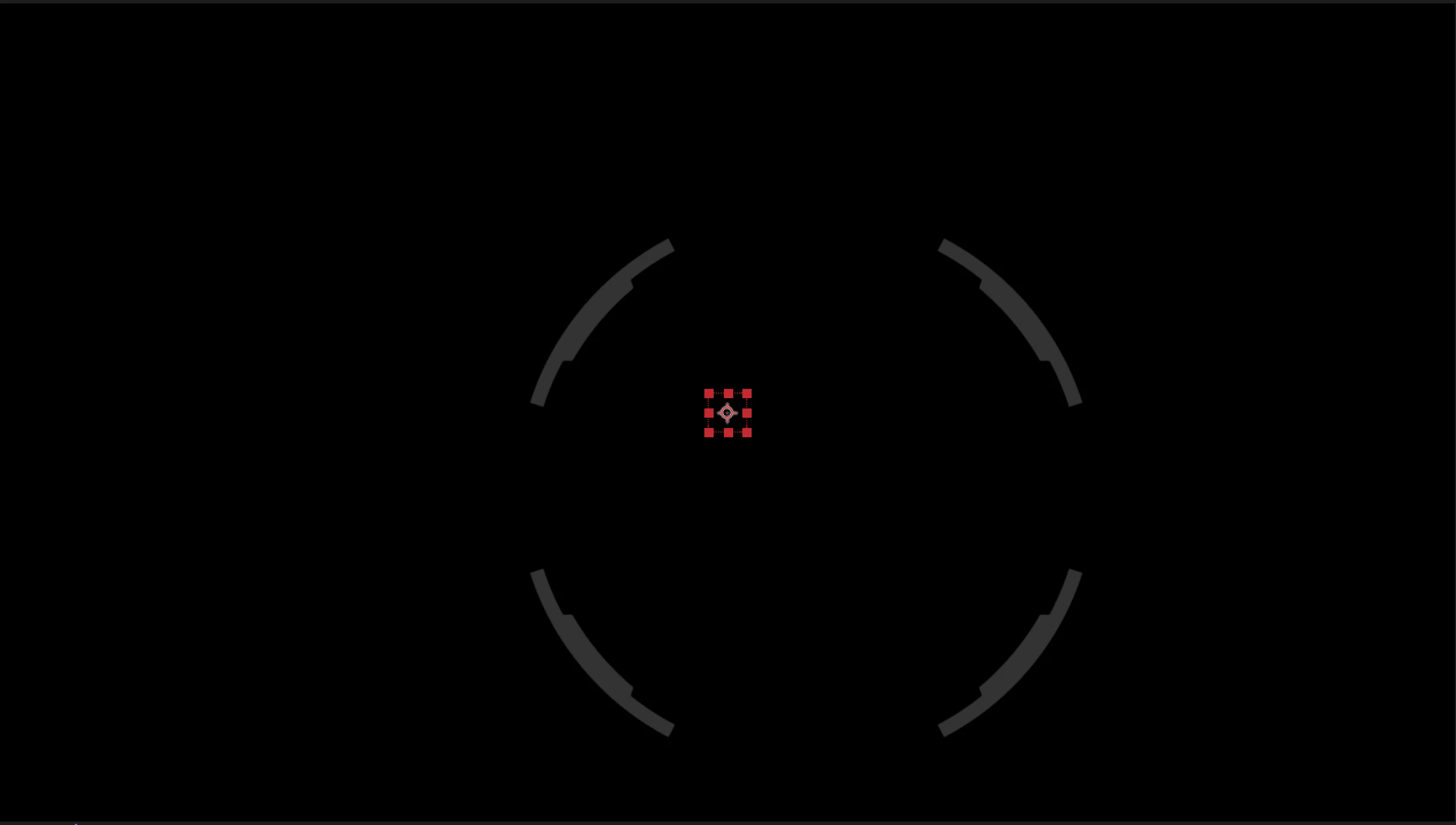

March 5, 2025
Ah, success! Your suggestion about linking the anchor point ot the scale worked for one of the objects. Then I tried using the mirror effect twice to create duplicates that now move the way I wanted.
Thanks for the idea!
