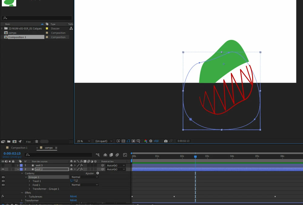

Hello everyone.
I use the "turbulent displace" effect a lot on my compositions, but I come up against a problem: the borders.
These seem to ignore the actual area of ​​my vector objects, cutting them off whenever they are out of frame.
Here is a screenshot, with the "missing" shape of the blow in red...
Is there anything I can do to fix it?

Pre-compose your vector stuff to a sufficiently large composition and apply the effect in the parent comp.

Hello.
I tested your solution. I created a squarred shape - in rose to be visible - behind my green shape, and created a precomp with these 2, but as you will see the problem remains : the 2 shapes now are both "eaten" by the border on the screen :

I had set a negative value for the "quantity" of the turbulence effect: that was the problem!
