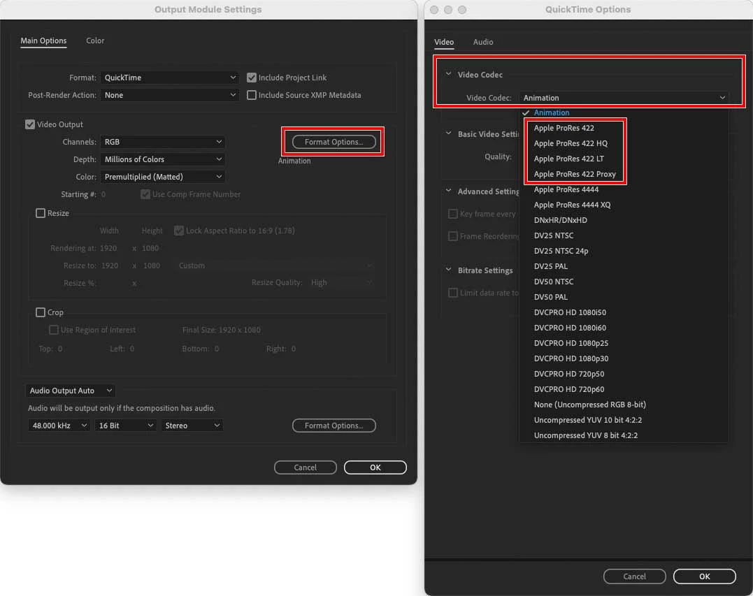

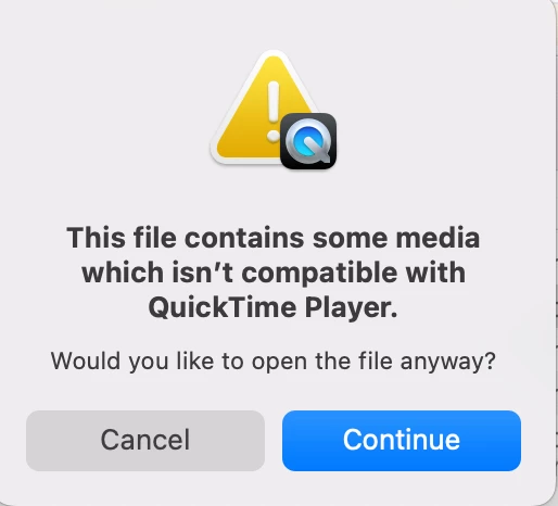

im attempting to render a file in after effects. In the output module custom settings i selected "quicktime" because i assumed this would render it as an apple prores 422 HQ video. when it is done rendering and i try to open it in my finder window im unable to open it
im working off a macbook pro

“QuickTime” is not a specific format, it’s a container for many potential video and audio formats and codecs. Everything from today’s ProRes, to the Cinepak codec from QuickTime 30 years ago. The problem is that Apple has dropped some of the oldest codecs, so if you weren’t being more specific than “QuickTime” then it might have been set up to render something that’s no longer supported.
What you want to do in the Output Module Settings window is click the Format Options button, and then in the QuickTime Options dialog box that appears, click the Video Codec menu to specifically tell the Output Module which QuickTime codec you want it to use. You can see that on my Mac, it defaults to the over 30-year-old Animation codec, not ProRes. If on your Mac the Video Codec is set to anything other than ProRes 422, go on to select the ProRes 422 variation you want, and then render the comp again.

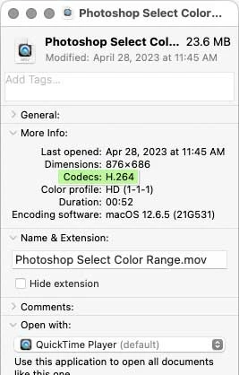

If you are wondering why the .mov file in the macOS Finder is not playable, select it, choose File > Get Info, expand the More Info section, and look at the Codecs line. Then check to see if the codec is one of those that is no longer supported by Apple in macOS, such as one of the old 32-bit codecs. In my example below, my .mov file uses the H.264 codec, which is fully supported in current versions of macOS, so it plays as expected.
