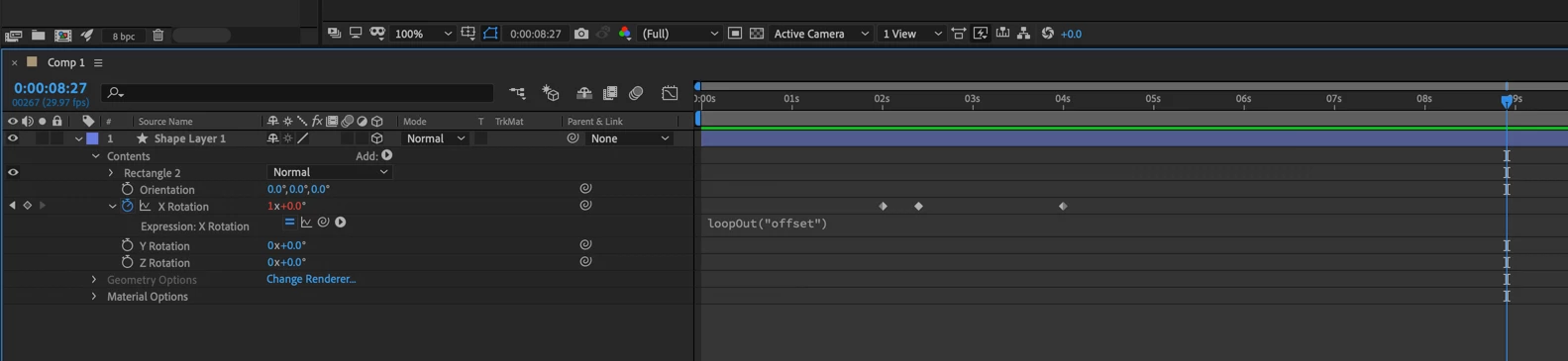

    By far the easiest solution is to use a loopOut("offset") expression and 3 keyframes. Move to the 5-second mark and set a keyframe of 0 x 0. Move down the timeline and set a keyframe of 0 x 90º, move to 10-seconds and copy and paste the last keyframe (0 x 90º). The loopOut("offset") expression will keep the loop/pause sequence going forever.
    I hope that makes sense.
    You can apply easing if you want, or even make the layers bounce to a stop by adding another keyframe and using the pen tool to edit the value graph.

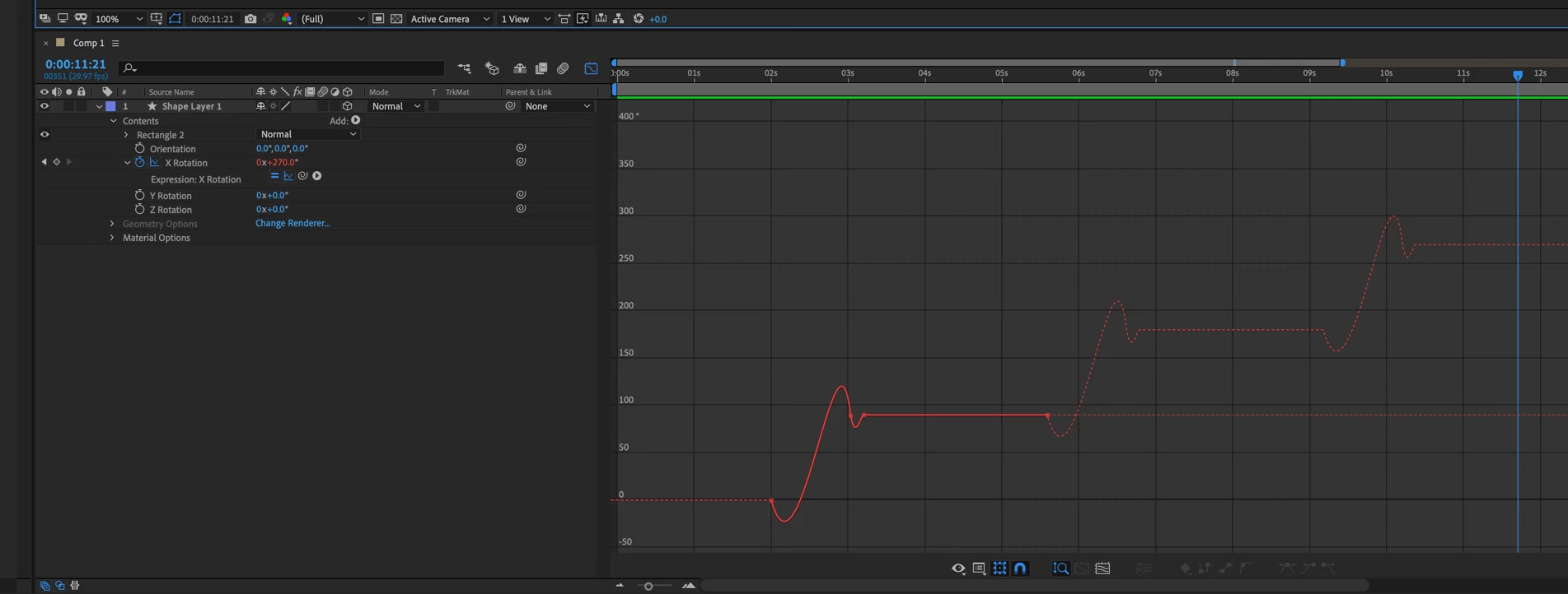

    I stumbled on this post and realized I just wrote a function that does this:
    function stair(x, period, amplitude, iterations) {
        var scaledX = x / period * 2 * Math.PI;
        for (i = 0; i < iterations; i++) {
            scaledX = scaledX - Math.sin(scaledX);
        return scaledX * amplitude / (Math.PI * 2);
    stair(time, 5, 50, 5);
    "Period" is how long in seconds you want from move to move, amplitude is the amount it moves (in your case it would be 90) and iterations controls the smoothness of the move... that is, a value of 1 is basically a skewed sin curve, and a value of 5 is almost a staircase.  Maybe someone will find this useful.
    Here's a pretty good tutorial on using the loop expressions that may give you some other ideas: https://www.schoolofmotion.com/blog/loop-expression-after-effects

    Thank you. That did the job. About as simple and straightforward as it could get.
