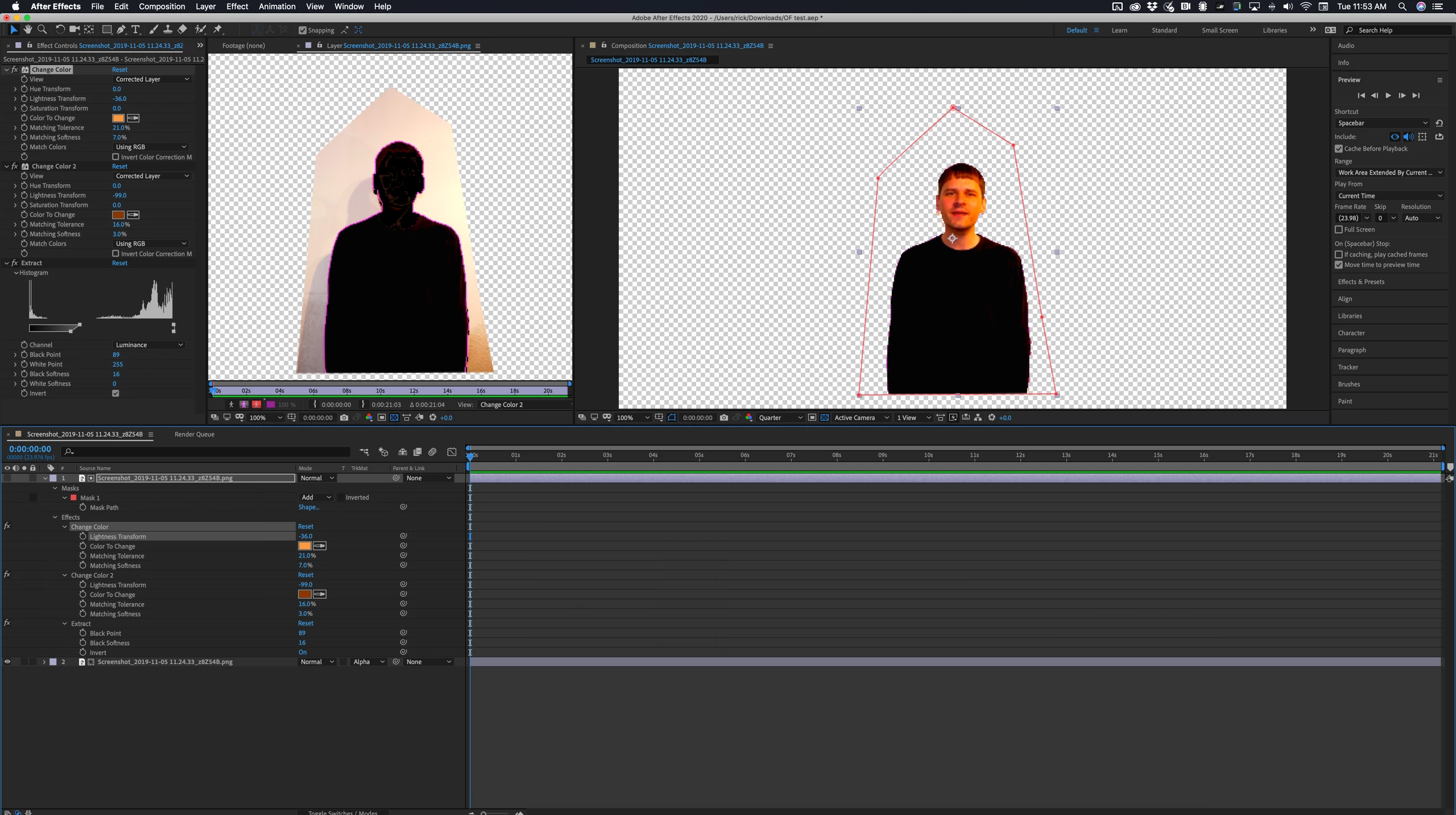

I took a screenshot of your screenshot, created a comp, duplicated the footage layer and drew a quick garbage matte. Then I applied Change color and sampled the face and darkened it until the shadows at the bottom of the screen started to block up, then I added Change color again and sampled the most saturated parts of the face and darkened it again until the actor was completely black. Then I added extract, inverted it, and adjusted the black levels to extract this matte. This is everything that I did to the layer. With your original footage, you should be able to get very close to removing the background in just a few steps. You'll only have a few keyframes for the mask unless the actor moves around a lot. This is what the comp looks like. It took less than 3 minutes:
If you post a full-resolution frame of the footage I can give you the exact settings that should work. Even if you have to do a bit of hand roto, this will be way faster than trying to use Rotobrush.
