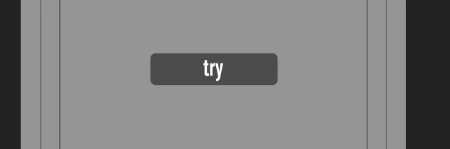

I have been using this expression for while to create a box about my text subtitles. the expression has been apllied to a shape layers size.
x=thisComp.layer(index-1).sourceRectAtTime().width+30;
y=thisComp.layer(index-1).sourceRectAtTime().height+25;
[x,y]
now for this to work I've needed a new shape layer for each new text.
Now I am not a coder and I have been trying to get ChatGPT to help me to modify this exprresson so it will work on multiple text layers instead of just 1. So I will have only 1 shape layer with multiple text layers above it.

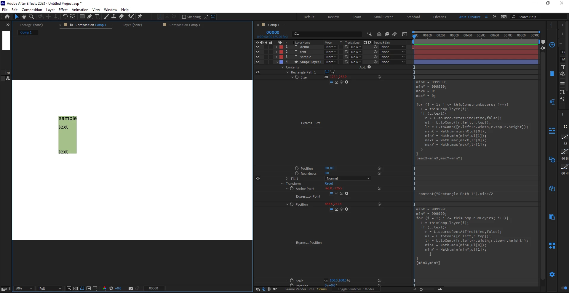

I've tried Dan ebberts expression. It worked fine for me. Except you have to take care of positioning the shape layer to match with the text layers. I've added following expressions to anchor point and position of the shape content properties.
To anchor point:
-content("Rectangle Path 1").size/2  // This would move anchor poin to the top left.
To position, reusing Dan Ebberts code to find the most top left point of all text layers within the comp:
minX = 999999;
minY = 999999;
for (i = 1; i <= thisComp.numLayers; i++){
L = thisComp.layer(i);
if (L.text){
r = L.sourceRectAtTime(time,false);
ul = L.toComp([r.left,r.top]);
lr = L.toComp([r.left+r.width,r.top+r.height]);
minX = Math.min(minX,ul[0]);
minY = Math.min(minY,ul[1]);
[minX,minY];
Thanks for the help.

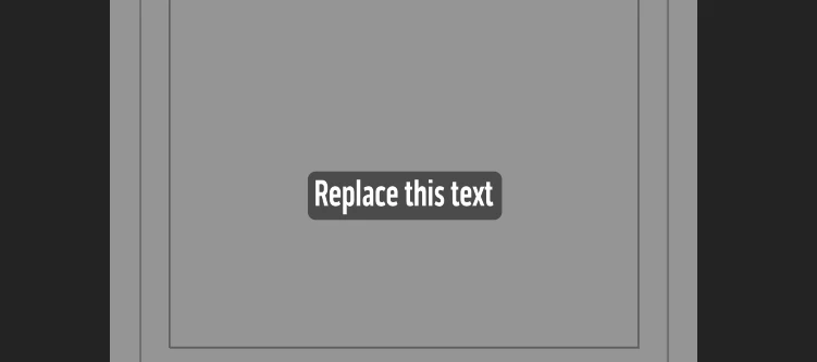

I did get it to work the way I wanted. I also found the script from Dan for creating text layers from a file which will be extramly useful. Thank you for that one Dan!. An oldie but a goodie for sure.

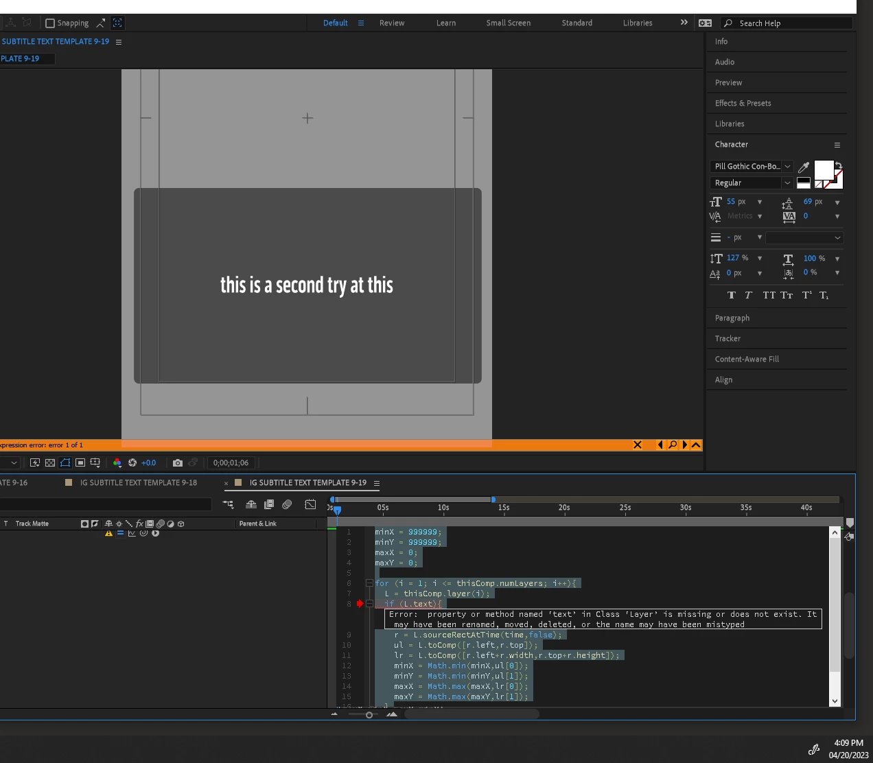

Maybe something like this:
minX = 999999;
minY = 999999;
maxX = 0;
maxY = 0;
  if (L.text){
    maxX = Math.max(maxX,lr[0]);
    maxY = Math.max(maxY,lr[1]);
[maxX-minX,maxY-minY]
Dan Ebberts

Thank you for your suggestion. Now when I use it i'm still getting an error code.
