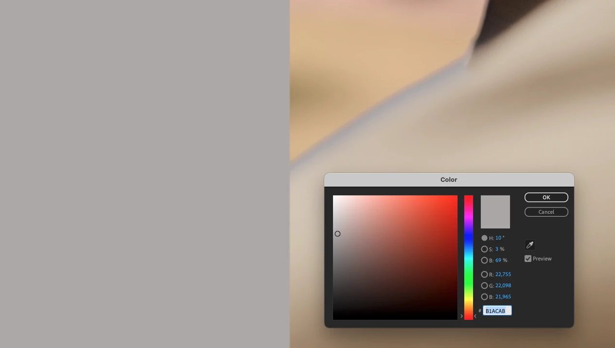

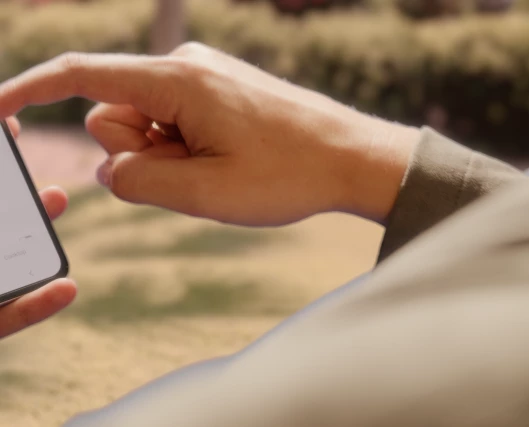

I've been running into this problem a bit latey and I don't know what's causing it. I'm keying this piece and when it came to removing the blue spill, I can't seem to get this to look right. When I use the eyedropper tool on that blue highlighted area at the top of the shoulder, it's almost entirely a neutral grey. But it still looks blue. I assume its just that the rest of the video is warm that the grey looks blue, but what can I do to make that highlight blend in more and not look so blue?

Duplicate the layer, convert it to greyscale, tweak the levels to bring out the blurred edges only, use it as a luma matte for color correction.
