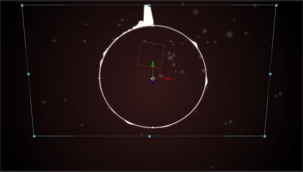

Cant seem to get the audio to go past the blue line? How can I resize the boundaries, without resizing or messing with the audio spectrum circle?

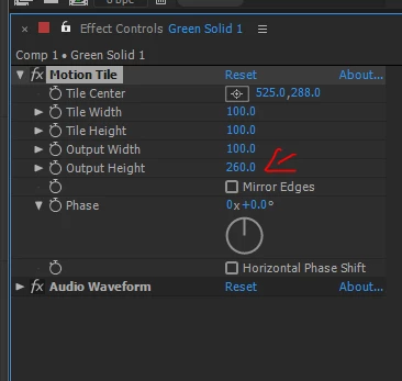

mbfxa, the blue line is your layer boundaries. the effect is going out of the solid boundaries - the layer you applied it to. you can increase these boundaries in a few ways. one way is to add the motion tile effect prior to the audio waveform and use output height. this will increase the height and allow your effect more room to grow.

Thank you!!!
