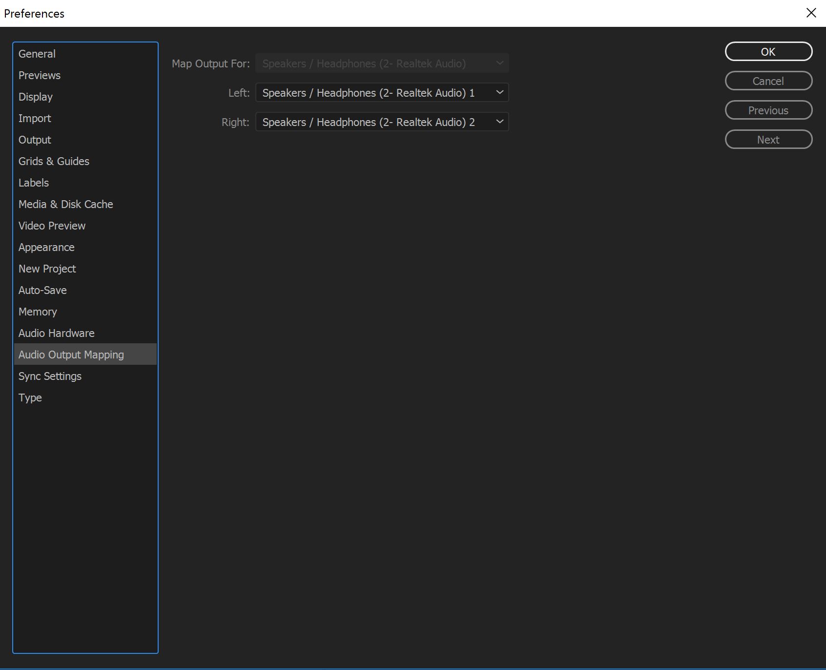

After Effects has been temperamental with audio on this machine. But generally it doesn't work. And right now it doesn't and hasn't for a while. It used to be that I could switch the hardware to ASIO. But this would turn off the sound for every other program. I have screengrabbed all my settings and I really hope one of you spots something!
I am getting the green bars suggesting that AE is playing and the output routing is wrong, but there is no option to change this. As you'll see below that box is greyed out in AE.

Here are the settings from After Effects including the preview settings:

Can I check: In your Audio Output Mapping is the first box 'Map Output For:' grayed out?

Yes - exactly as your dialog.
