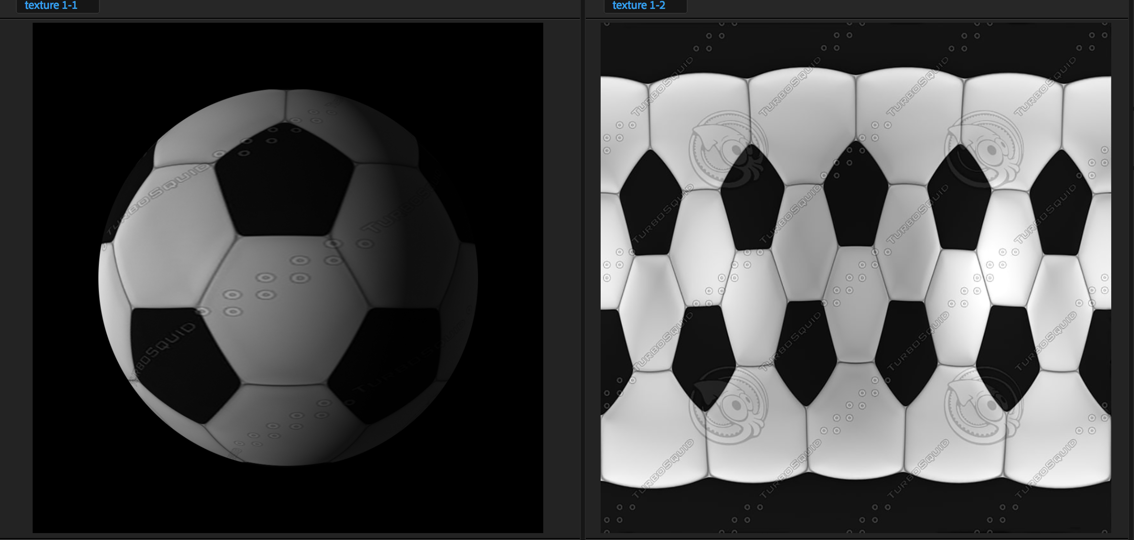

I have been looking for an answer to a problem all day long and this forum is my last hope, so here it goes. I need to do some motion graphics which will ultimately result in a projection on a sphere.
Making something 1:1 or 2:1 will pretty much do the job except that at the poles the distortion is quite unacceptable. I have been using as a test, the CC Sphere Fx as it pretty much replicates the real sphere.
Nothing I do seems to get rid of the distortion at the poles. I downloaded an HDRI image from a website and when using the CC Sphere on that image, it maps the sphere PERFECTLY.
I looked at sites like TURBO SQUID for textures for spherical items and I downloaded a football texture which when used with the CC Sphere worked marvellously well. ( I am attaching that image as an example) so my question, or better, questions are:
1- how to make an HDRI image?
2 - How distort my existing content into something along the lines of the football texture?

    March 30, 2018
    Let me say one thing about dimensions for an image that you wrap around a sphere. If you want an undistorted equator and pixel for pixel accuracy for the most resolution you have to use basic geometry and figure the height of your image when it is rendered.
    Let's say you are working in HD and you want to push the camera in to focus on approximately 1/4 of the sphere. Think of that portion of the image as a square. The height of that square would need to be 4 times the height of the comp or 1080 * 4. That makes the vertical dimension of your spherical map 4320 pixels. To figure the horizontal dimensions of your "texture map" you multiply that dimension by π (3.141...) because the formula to calculate the diameter is C = π D or 2πR. The texture map should be 4320 X 13570. The ratio Dave suggested is 2:1 but it really should be 3:1 to avoid horizontal stretching. Every pixel should except the ones around the equator are going to be re-interpreted to fit the sphere, but to keep squares close to square you need to follow the rules of geometry. The sample texture map works because it is stretched to fit, but the pentagons are already squished.
    Here is some more info on HDRI images: Size and Distance in HDRI Maps | HDR Light Studio Blog
    If you want to create the distortions necessary to use the images as environment maps then you'll need 3RD party plug-ins or you'll need to take a bunch of flat images and use the ability of AE to create a projector and project them on the inside of a sphere. The workflow required and the tools to make the process more efficient depend entirely on what you are trying to do. It would really help us if we knew exactly what you are trying to accomplish and what resources you have.

    March 29, 2018
    That one won't work properly with CC Sphere -- it's not a 2:1 ratio.
    Miguel_RAuthor
    March 30, 2018
    Dear Dave
    Thank you for your reply. The texture works just fine with CC Sphere. Looks like a 2:1 and a 2:1 produce the same result
