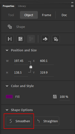

Thank you, yes I see the issue on this particular asset. To avoid it, you can select the shape, go to the properties panel and press the Smoothen button once to rearrange the vector points a bit. The tool should now wrap around the shape more accurately.

Thank you, Mario, that certainly helped. It still modifies the shape slightly but its way better than before.
