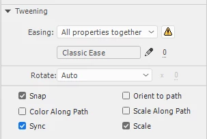

To fix this, select your layer with the tween and choose 'sync' in properties.
