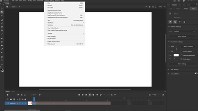

If your audio is set to Stream and you still can't hear it - can you give us the spec on your actual audio file? Sample rate and bit depth is what you need to pay attention to.
Generally, when using WAV or AIFF files, it's best to use 16-22 kHz mono sounds (stereo uses twice as much data as mono), but Animate can import either 8- or 16-bit sounds at sample rates of 11, 22, or 44 kHz.
Had the same issue, and the problem was not the sound sync was not set to Stream or the Khz value.
I accidentaly muted my audio.
The default shortcut to unmute it is Ctrl+Alt+M, or click on Control button on the main toolbar and make sure the option Mute sounds is not enabled. Thank you everyone for providing solutions!

you can't hear the audio when you scrub the timeline?
Copy link to clipboard
Copied
Yea, I can't hear it at all on the timeline

your sounds sync property is event, not stream.
Copied
I changed it and it still didnt work

embed a screenshot of frame 1's properties panel showing the sound subpanel.

click the control menu item at the top of animate shown by @Arbiter267. are your sounds muted?
if not, upload your fla to a file server and post a link.
