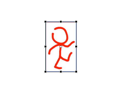

    If you're talking about many seperate images of sprites then yes you can!
    Turn on multiple frame select and drag the selector over the span of frames you would like to align, then use the lasso tool to select the objects you would like to align.

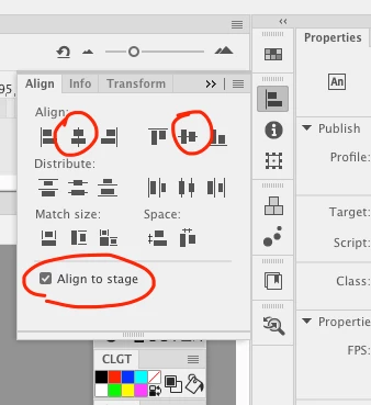

    Once your objects are all selected, go over to the right hand side, or whereever your prefrence panel is, and find the align tab. (If you cant find the button just navigate to the top of the screen to Window/Align)
    Make sure "Align to stage" is checked, and hit the vertical and horizontal align buttons to move all the objects into the same position.
    Hopefully that's what you're trying to do! If the objects are different sizes you will still have to do some manual adjustments.

    This is exactly what I was looking for, thanks!
