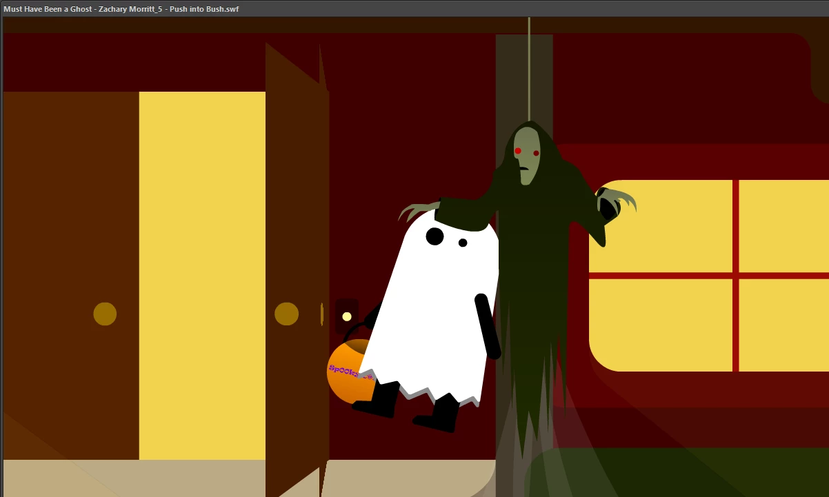

When I try rotating the door in 3D, it teleports over to the left a ways and rotates around that axis instead of where I want it (at the door). However, when I export the .swf file, it renders differently. Instead of teleporting to the left, it just jitters about the hinge and that's it. I'm really confused. Any help would be appreciated.

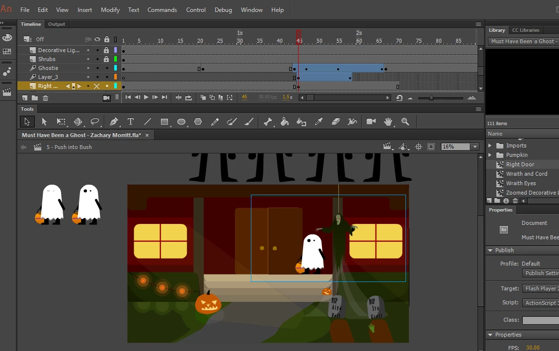

Here is the door at the beginning of the motion tween
Here the door has swung all the way to the right. Note that the center point for the rotation is on the edge of the door, but the door itself rotates well beyond that axis.
When I export the scene, the door doubles up and glitches around, but doesn't swing all the way to the right as it does in the timeline before I export.

seems like there is too much involved, especially if you are new to Animate.
I suggest using a simple shape tween with shape hints.
So place your door (closed) in one keyframe as an Ungrouped Object (not a symbol - or press Command B to break it apart from the library and make it an ungrouped vector object) then about 5-10 frames down the timeline place the art for the open door as you showed in your screenshots above (also make sure it is ungrouped) then right click between these two keyframes and select "Shape Tween".
When you play it back it won't look like you want it... .but now you just have to add shape hints one at a time to lock in the pivet points.
But once its complete it can't be moved (since it will disrupt all the shape hints) so might be smart to create this in a movieclip so you can move it and scale it and even recolor it.
Hope that helps!
