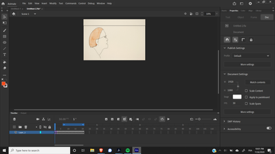

It's at the bottom of the timeline:
For some reason even when I do this and make sure it emcompasses all the frames I want to move, it's incredibly unpredictable. Sometimes it would work but most of the time it still only moves the one frame. Is there another option like grouping frames together as a self contained animation and then just moving it. I am using sprites so every frame is a dedicated png I've exported and trying to move and scale them one at a time as I import them in is a pain already, it's even worse when I want the character to move around the screen.
