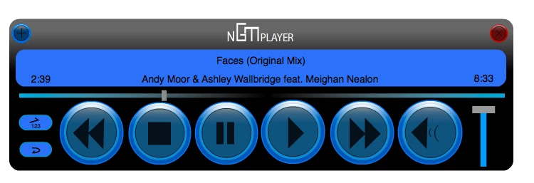

Whenever I try to run my mediaplayer with the following code it was working and the scrubber bar was moving automatically with the song in my ENTER_FRAME function. Now it doesn't and when I go to play a song the trackknob is stuck in a spot along my scrubber bar like it is glitched or something???
Here is my media player and as you can see when I start the song with the playSong() function the trackknob doesn't start at the start of the scrubber bar.

May 8, 2013
#1:
you might have a problem in your dropIt2 fucntion:
you are using an anonymously
stopDrag()
and later on (in the same function:)
seekBar_mc.sliderSeek_mc.stopDrag();
without having insight in how your dragging/dropping is supposed to work  I can only guess that both refer to the same object(?)
if, you should use sth like:
e.currentTarget.stopDrag();
#2:
if you are using mp3 files to stream you can`t calculate the length of the sound file with this formula:
var estimatedLength:int = Math.ceil(my_sound.length / (my_sound.bytesLoaded / my_sound.bytesTotal));
since mp3 (and most lossy codecs) don`t distribute their filesize uniformly over the runtime (you would have to use a lossless format like wav for that to work)
so you will have to include the runtime of your playlists`songs into the xml files which you can then use:
var myDURATION = my_songs[mySong].@DURATION;
kglad
