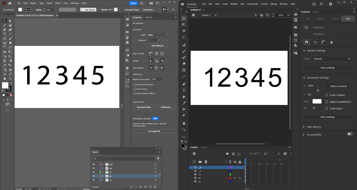

The importer does preserve layer names from Illustrator, unless the name starts with a number or a special character in which case the character will appear with an underscore "_".
Make sure Convert Layers to: Animate Layers is selected.
Result:
About your second question, by "bones" I assume you mean warped assets, they're not the same as symbols. They can be edited as well, albeit in limited form and only from the library. Select the warped asset (from the library) and click Edit.
Result:
*Please note that editing is only possible on versions 23.0.0 and up.

The naming convention won't change to how it was in Flash because if I recall, this is linked to the functionality of advanced layers and allowing these characters at the beginning can create conflicting errors. I agree with the rest of your points though, you can write your suggestions to the dev team using this form:
https://www.adobe.com/products/wishform.html
